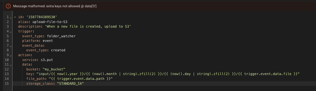

That is not even close to your OP posted code. Again to be clear, you aren’t using the suggested format for your file path.

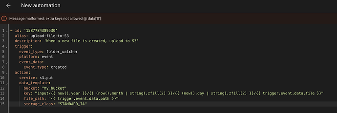

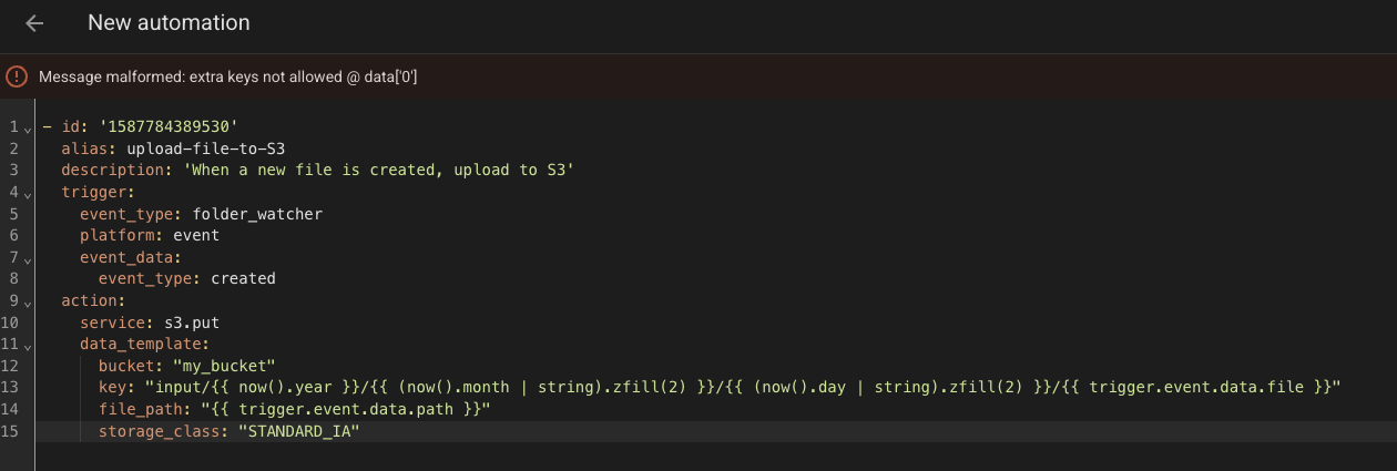

When I use your example code I get a similar error:
Am I just not understanding how to call a service from an automation?
What happens if you change data_template to just data?

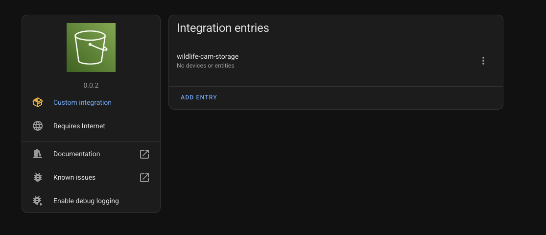

Same error, unfortunately. Also if I try and find the concept of this s3.put service through settings there is no reference to it. If I look at the config for this integration this is all that is listed:
Which is why I was opening with a general question as to how I might best do this, I’ve assumed this old integration just doesn’t work anymore. I’ll probably have to write a custom server to do the upload for me and use a webhook to send the image data instead. I was hoping someone else might have already solved this problem :slight_smile: thanks again for your time.

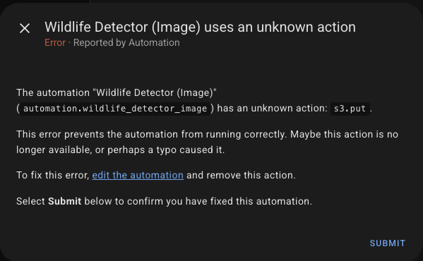

Thank you for trying, that lets me save it, but then I get this error:

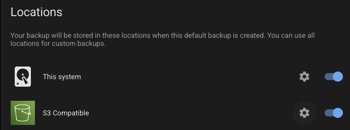

The integration does show up as a backup location so it’s installed correctly:
I’m not so sure whether it’s installed correctly. Home Assistant is complaining about an unknown action, so maybe something is going wrong when the custom component is registering the service. Can you find it under Development Tools-Actions?

I think I know what I’ve done here… I’ve confused GitHub - PhantomPhoton/S3-Compatible: A custom component to enable using S3 compatible endpoints for home assistant backups with GitHub - robmarkcole/HASS-S3: Home Assistant integration for S3 and installed the wrong thing :man_facepalming:
Let me try manually installing the correct thing.
