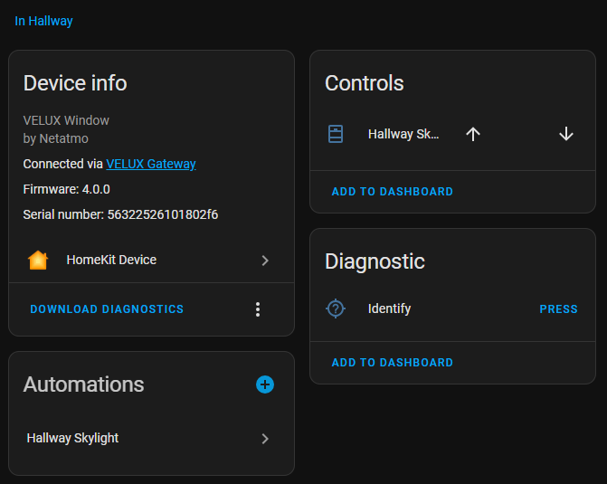

@lucaberta thanks for the screenshot, that looks nice.
my velux skylights each had a voucher to upgrade the remotes for $35 to get the KIG 300, so ordered that yesterday! …can’t beat that deal.
as for apple home kit, from what have seen, during the KIG 300 install/setup it will prompt for connecting via home kit. At this step you do not continue with the velux app and just reboot home assistant. HA is supposed to discover the home kit and intercept it for setup on HA as a home kit controller. Then you continue the setup in the app. I still need to read up more on this… I’ve come across several threads about this, so still cobbling together my notes.

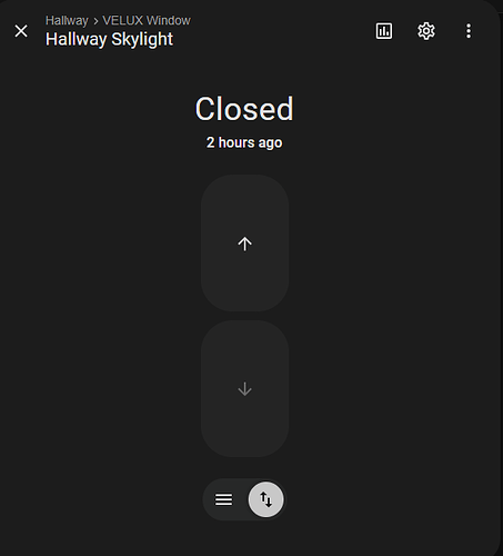

if you press on the button at the bottom of the control, you also have access to a view which mimicks what the typical control buttons on the wall are:

Do the controls not have a stop button? The remotes have a stop button next to up and down. Could be useful. :slight_smile:
No stop button indeed. I guess the reason is that the UI concept is different between standard 3-button remotes, and App/KIG300: the remote gives an order to move in one direction, continuing until it hits the end position, or you stop it with the stop button. In the App or via KIG300, you select a target position, and the cover will move there and stop when it reaches the target position. You changed your mind? Give it a new target position.
