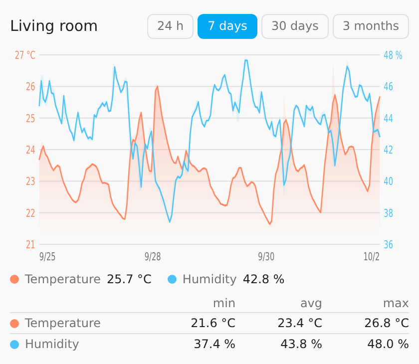

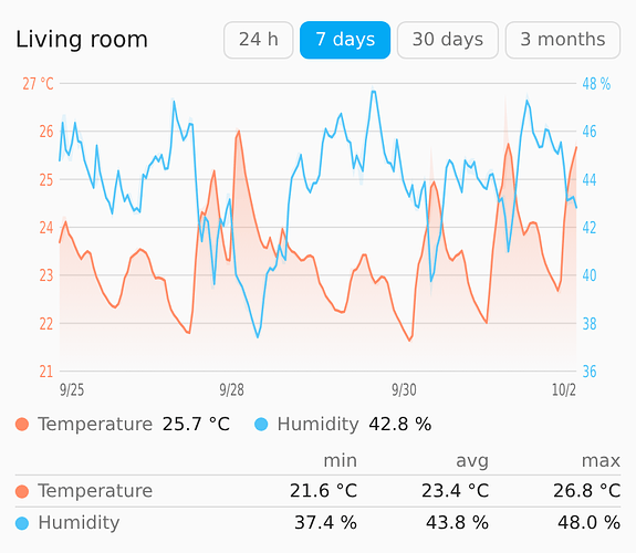

I was annoyed that for charts I always had to jump over to Grafana. I wanted an open system, with everything in one place, right at hand. I also wanted nice long history, and HA cuts it.
Now I have everything right at hand. I open HA, my floor plan is right there, and when I tap the temperature in a room I get nice data straight away, the whole history. No database password in the browser, and it works remotely too.
It’s for anyone who wants everything in one place, right at hand.
