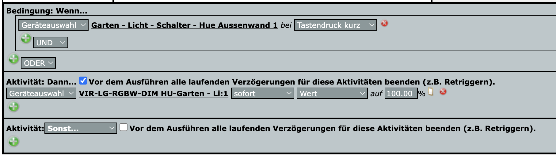

I am using a Homematic IP CCU 3 and have a HmIP-WRC6 Wall Switch with 6 Buttons.
The switch used to control some Philips Hue Lights. I am now in the process of moving the programms from Homematic IP to Homeassistant.
I created the automations on HA yesterday and deactivated the old programs on Homematic CCU. First, everything was working, my Philips Hue Lights where correctly being turned on and off.
Then I deleted the programs on Homematic CCU and suddendly the Switch stopped working (No events received anymore in HA). That kinda sounds like the problem described here: Homematic - Home Assistant
BUT: I am already using the custom integration GitHub - SukramJ/custom_homematic: Custom Home Assistant Component for HomeMatic
For anyone finding this thread. I managed make it working by just adding a programm in homematic IP, which triggers the light when clicking on the switch:
So basically the same, what I also do in Home Assistant.
The programm in homematic IP can be deactivated, it seems that it’s enough that it just exists.
Having that programm, the events of the switch arrive correctly in Home Assistant.
