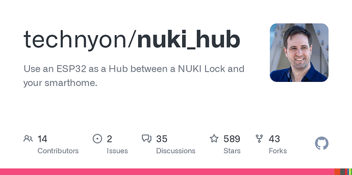

I would say the add-on doesn’t work anymore. You should use the Nuki Hub ESP32 alternative:
