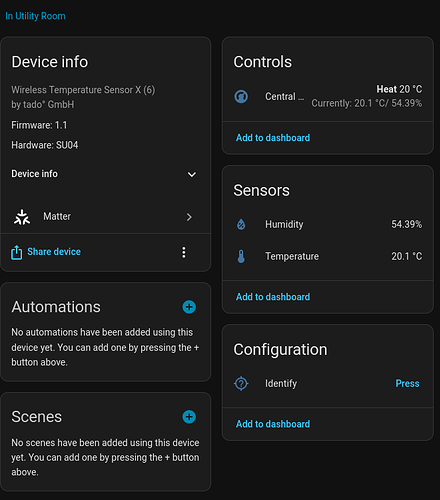

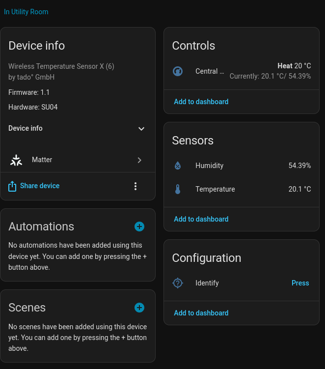

  • after starting the pairing in the Tado Android app a Matter device will appear in HA like this:

I’ve been trying to link all of my Tado X devices to Home Assistant through Matter. Among other problems, here is the weirdest one.
I have two identical Wireless Temperature Sensor X units placed in different rooms. After adding both to Home Assistant (via Matter shared from the Tado App), I am getting different entities for each:
  • Sensor 1: Shows climate controls AND temp/humidity sensors.
    • Matter Firmware: 1.1 | Tado Firmware: 276.2
  • Sensor 2: Missing climate controls, showing ONLY sensors.
    • Matter Firmware: 1.0 | Tado Firmware: 280.1
It’s strange because the sensor with the newer Tado firmware (280.1) seems to have an older Matter version (1.0) and is missing features.
Has anyone else seen this inconsistency? Is there a way to force the Matter firmware to update, or is this a known issue with the 280.1 rollout?
There are two variants of the Wireless Temperature Sensor X. CSA lists them with Product ID 0x0003 and 0x0006. 0x0003 is certified with firmware 1.0 as a Temperature Sensor (Device Type ID 0x0302) and with firmware 1.1 as a Thermostat (Device Type ID 0x0301). 0x0006 has only one certification with firmware 1.1 as a Thermostat.
My Wireless Temperature Sensors have a Product ID of 0x0003 and also only show temp and humidity. I’m on Tado firmware 276.2 and Matter firmware 1.0. I’ve bought them on release date. Interestingly they also had climate control with one of the early Tado firmware.
If you look at the DCL the only available Matter firmware for Product ID 0x0003 is version 1.0. I think we have to wait until Tado releases a new matter firmware. Both variants are capable of acting as a Thermostat.
