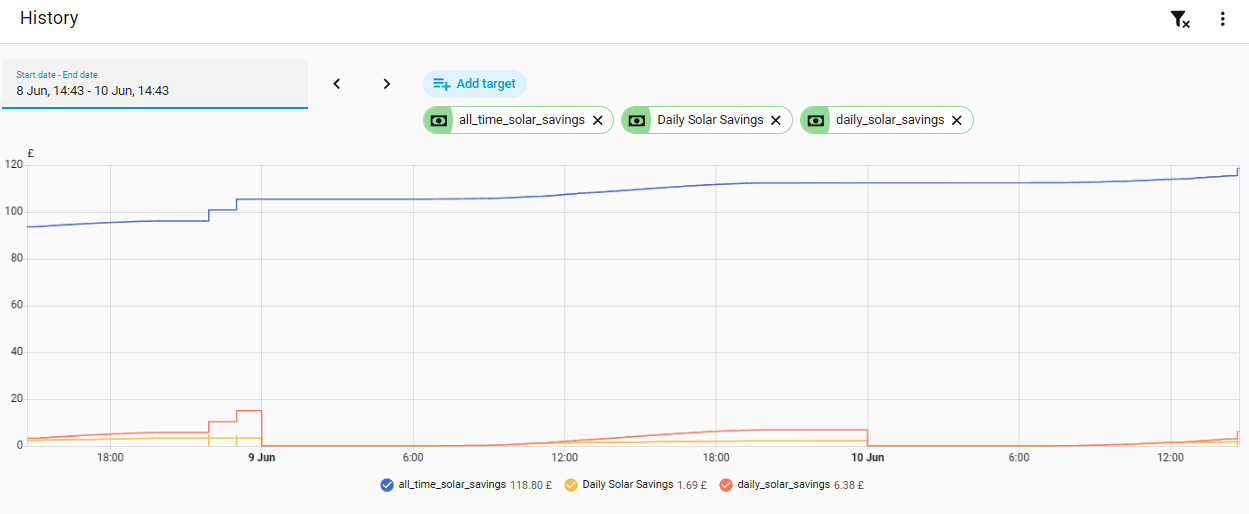

Hello. I'm new here. I've been using HA for a couple of months and have learnt lots. I'm trying to track the money I am saving from using solar energy, rather than purchasing from the grid. Everything is working pretty well, but I'm having a problem with the way my daily values are summing using utility meters. I have various template sensors, including one called Daily Solar Savings defined in template.yaml, which calculates the baseline cost of the energy generated and not exported:

The problem is that I am getting small glitches and down-ward movements in my daily savings template (some unexplained, some when I restart HA). These make minimal impact to my daily readings, but they causing significant jumps in my accumulative utilty meter readings.
I can't work out how to fix this. I've tried setting state_class to measurement, rather than total, but that didn't help. Any pointers would be really appreciated.
Add an availability template to your template sensor.
Thanks very much - I wasn't aware of this requirement. I've added the availability templates, and will monitor things over the next few days. Fingers crossed.
