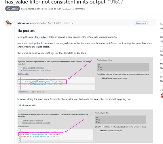

  1. What is the learning of has_value filter not consistent in its output Ā· Issue #91607 Ā· home-assistant/core Ā· GitHub regarding the ā€œhas_valueā€ usage?
  2. According to 2023.4: Custom template macros, and many more new entity dialogs! - Home Assistant has_value ā€œonlyā€ filters unavailable and unknown - right? Is that really sufficient for an availability template? So far I always checked with several other states like:
{{ states('sensor.abc') not in ['NULL', 'null', 'none', 'undefined', 'unavailable', 'unknown', ''] }}
Got it. Unless @Sir_Goodenough has good arguments to check for other states :slight_smile: I’ll likely migrate all my availability templates to the way more simple has_value function.

this might be outdated by edits, but sorry I missed it, somehow I didnt get a tag.
where in my examples do I use the incorrect syntax you paste there?
In multiple places you are using:
{{ ('binary_sensor.boiler_on')|has_value }}
That is incorrect. You need to use the states() function with the has_value filter, like this:
{{ states('binary_sensor.boiler_on')|has_value }}
Only if you use the has_value() function can you do:
{{ has_value('binary_sensor.boiler_on') }}
Hmm. I can’t find the templates you say I am using .
Do seem to recall I had made that mistake before, but not in this thread ? Odd.
just checked my complete config, but dont even use a has_value in either syntax at all on the binary_sensor.boiler_on
(I just like to know, because I can then correct a fluke)

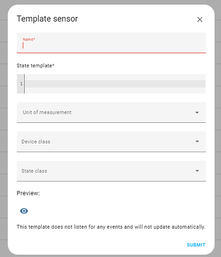

Thanks for the suggestion. I had seen availability in some examples but didn’t know what it was for.
I know it’s a contrived example, but you cause the problem by using default zero in your float conversions. Leave out the zeros and the template would be unavailable when either sensor is unavailable.
state: "{{ states('sensor.one') | float() + states('sensor.two') | float() }}"
That would fill your log with errors and may disable your sensor. The availability template method won’t.
