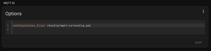

First MQTT (Addon page, config.yml, configuration, and log), then Mosquito (same) then Dreame
1. MQTT
a. Settings>Addons>MQTT IO and the Configuration tab
b. MQTT add-on logs (Seems to me it’s all ok)
c. the config.yml itself
