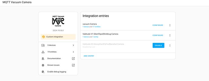

The vacuums Rand256 are not providing sensors data to home assistant, so in the release 2024.10.0 will introduce the sensors for Rand256 users. The camera startup was refactored and a beta 2024.10.0b3 have been release today.
This update also improved the code for the function introduced thanks @hayvan96 suggestion.
I would be testing this 2024.10.0b3 and report any unexpected behaviour would be really appreciated. Thanks as alway for the cooperation :rocket:
