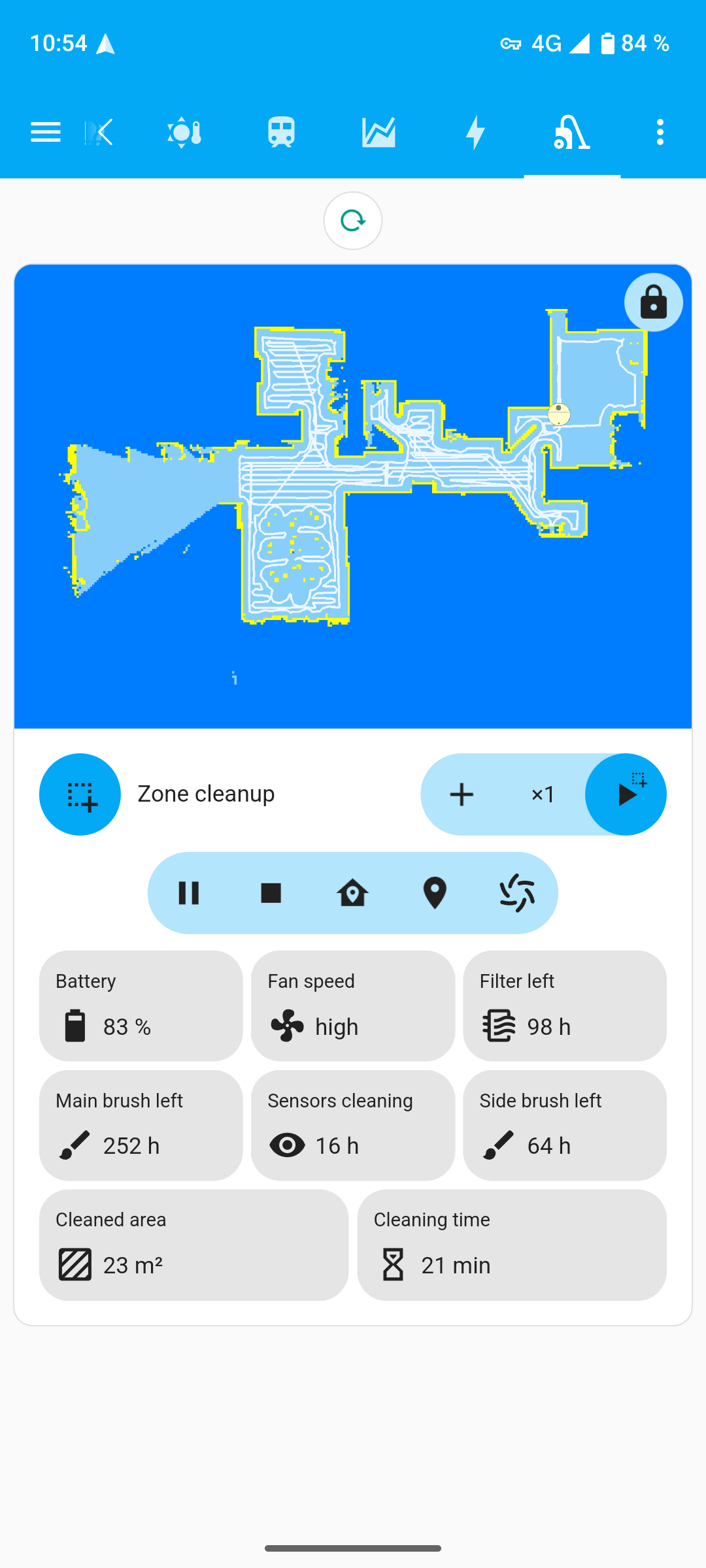

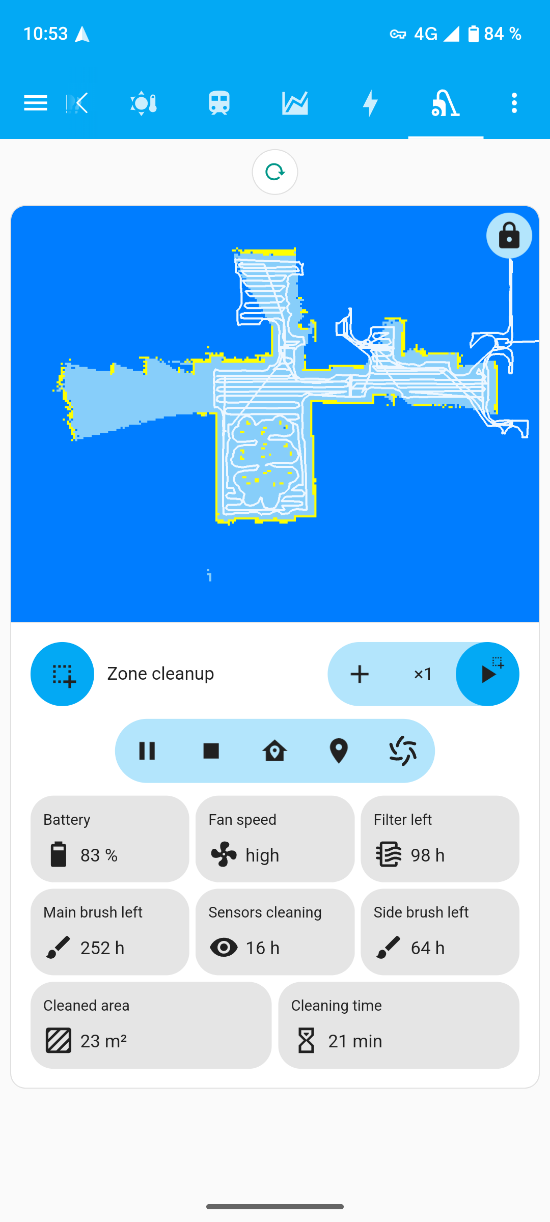

Since auto reset trims has been removed, I still have this issue that when I change floors, my S50 doesn’t update the discovered map.
See for instance how it looks then how it should look (manually resetting trims).
How do you guys manage this? It used to work with 2024.10 but it’s no longer possible as not compatible with recent HA versions.
Dear @hayvan96
I will add in the next release the possibility to save the floor name / data and save the trims for one or the other floor, this can be a possible solution to re-enable the reset trims, instead of reset trims the action will be change floor.
I did intend to do this since a while but I got stuck with a bigger issue that now is fixed.
@hayvan96
Unfortunately I will try to implement this hopefully on the 2025.9.0 the next should go out next week and I’m currently working on this and there are a couple of other things to fix there… possibly I will release some beta in the meanwhile.
