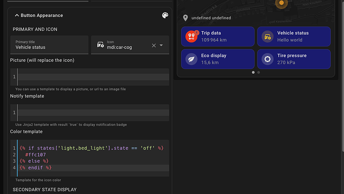

About the buttons…
Is it possible to have the entity picture of an entity in the icon part?
I would like to have a button to fuel the car, i already have an entity (from carbu) which holds the right picture of the tankstation…
Hi @skank yes I can add a template config to replace the icon. I will prepare it for the next release. :love_you_gesture:
update: done :tada:
picture_template
Perfect! Thank you so much

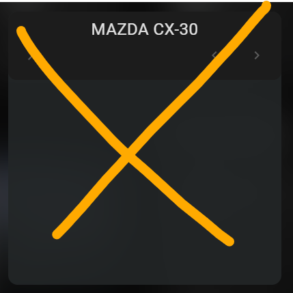

I’m coming here after spending days trying to find out the reason of my problem without sucess. Here is the thing:
Some days ago the vehicle status card has simply disappeared from my panel. I’m not aware to change anything from the configuration. When I say ‘has disappeared’ means that, even tough the yamel code is there, nothing show up. Does anyone experienced anything similar?
Only thing I remember was the upgrade to homeassitant 2024.12.x, but I restore a backup version of 2024.11 and didn’t fix it.
Here is the code, just in case anyone can also try to get your feedback.
Thanks.

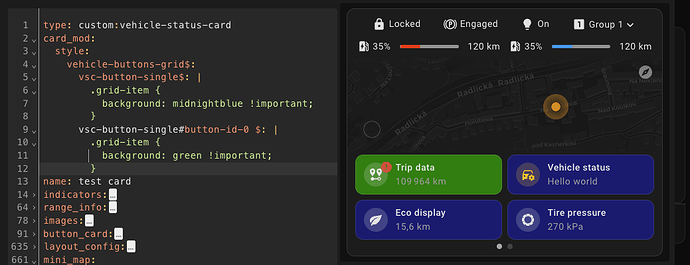

Hi @KingFisher, sorry for late reply… for buttons icon color and its shape background, you can modify in color template… like this…
and for button background you can use card_mod to customize styles, each button has its own id with its index… for example change background for buttons… and another styles for first button…
card_mod:
  style:
    vehicle-buttons-grid$:
      vsc-button-single$: |
        .grid-item {
          background: midnightblue !important;
      vsc-button-single#button-id-0 $: |
        .grid-item {
          background: green !important;

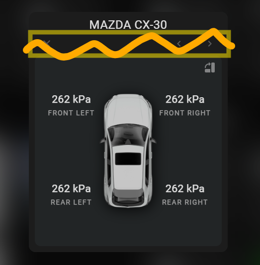

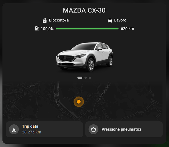

Hi, first of all thank you for the amazing job!
I’m using base setttings of the card, my car isn’t electric and I don’t need to show much, so my buttons at the bottom shows odometer and tires pressure only.
When I press the odometer I need to do nothing but it opens an empty window, and for the tires I need only one screen showing… the tires pressure. How do I remove the arrows slider at the top? maybe I wrong something in the card config…
I’d like also to set a tire pressure notificaton, can you please post an example?
