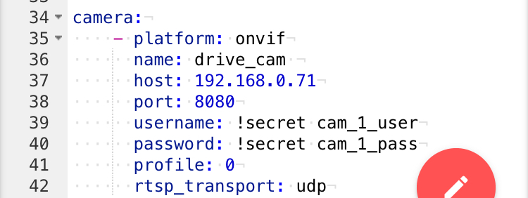

This is my setup, it is strange you are getting that error
Just looking at this again, I also get that warning but doesn’t affect the feed I see in HA
I don’t however get the error, I think this maybe and issue with you username and password are they in single/double quotation marks ?
My configuration is this:

- platform: onvif
  host: 192.168.1.42
  port: 8080
  username: admin
  password: 123456
  profile: 0
  rtsp_transport: udp

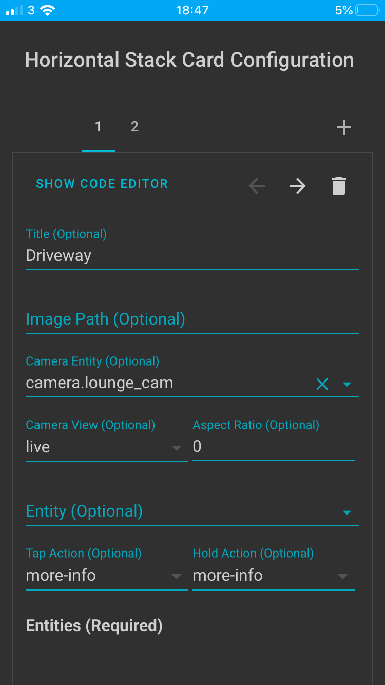

When setting up in love lace have you set camera view to live ?
Yes, I did this but I still can’t see anything.
