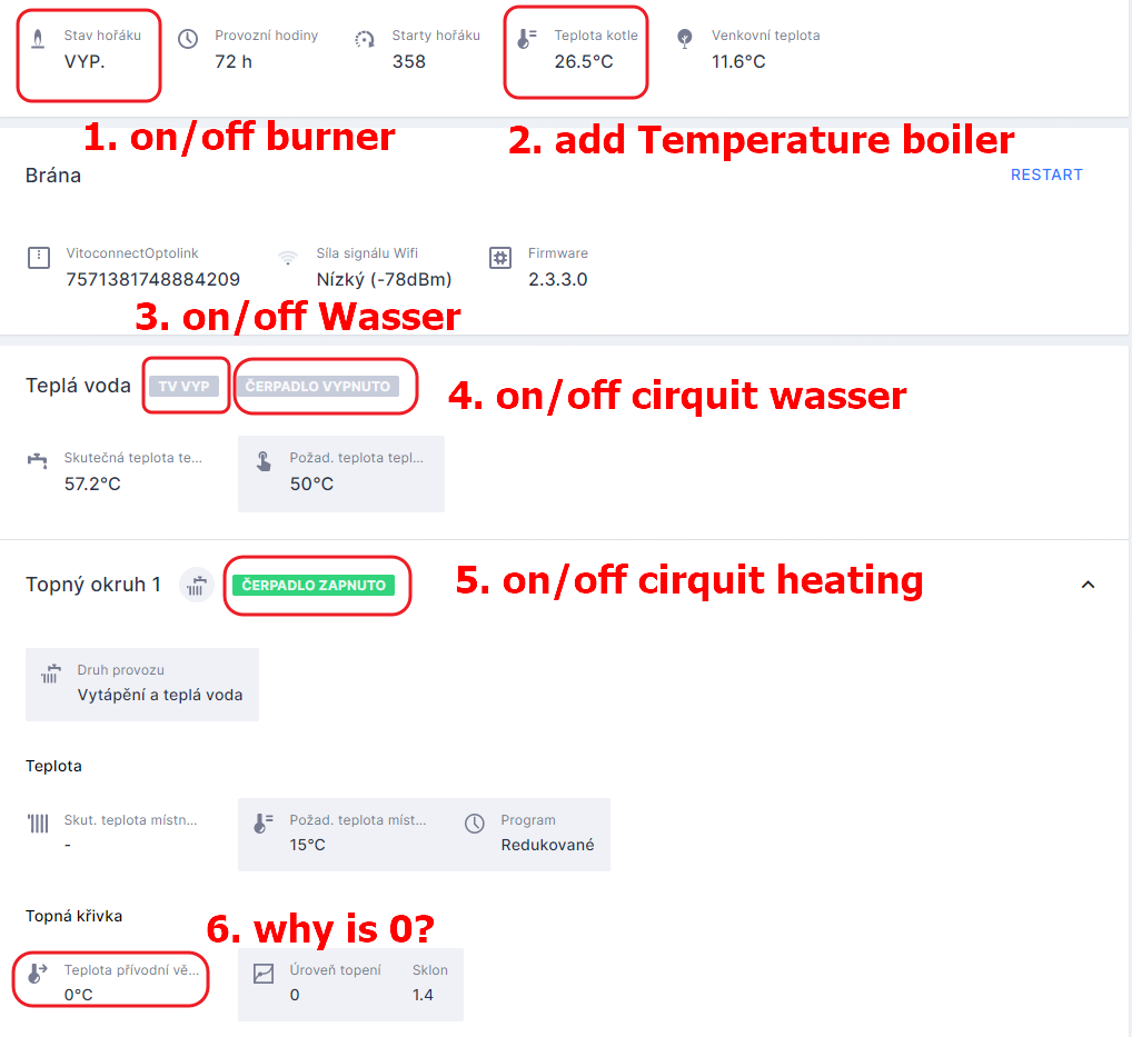

Hello. I’m calling again after a while. Will it be possible to add the parameters marked in the picture to ha_vicare, please?
- burner condition
- boiler temperature
- Water heating pump on / off
- water circulation pump on / ff
- circulation pump for heating on / off
and in point 6 I still have 0, which is displayed in the Home Assistant. Is it possible to optionally replace this parameter in ha_vicare with the parameter in point 2?

Hi and thank you for the reply. I looked at the link you are pointing to, but I am able to get the maximum circulation pump from it. I get everything else you mention, but I don’t get the points I mentioned. In particular points 1, 2, 3, 4. From this reference it is possible to get either point 5. I may be wrong, but I do not see another option for the condition of the pumps than this:
vicare_circulationpump_active:
friendly_name: "Active circulation pump"
value_template: "{{state_attr ('climate.vicare_heating', 'circpump_active')}}" "
Would it be possible to add the existing ones, at least their names in the API, so that the code can be added?
I’m sending now how I have my boiler room set up. There are a lot of measurements, I managed to get a lot of information with the help of InfluDB and Grafan (information from Vicare that HA doesn’t even know about) and then other heat sensors are used, which I installed on various pipes using ESPHOME.
So I added a code for the heating circulation pump (point 5) and it works ![]()
Just please points 1-4 and I will be very satisfied and I will be able to create an animation for running pumps in HA
So will it still be possible to get codes for these points?
Point 6 is probably a mistake on the part of Viessmann.

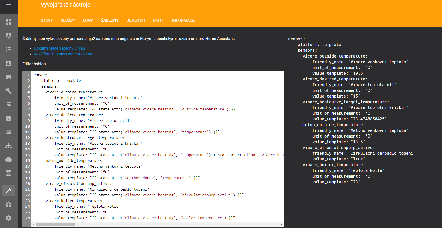

FOR ALL who are having problems.
Your name from the component may differ then in the demo config…
The name which the climate.vicare_heating gets is the one you give it in the viesmann app!
Sooo just search for ex. outside_temperature in the developer tools and you will find the name
replace it with the outside_temperature and voila it works ![]()

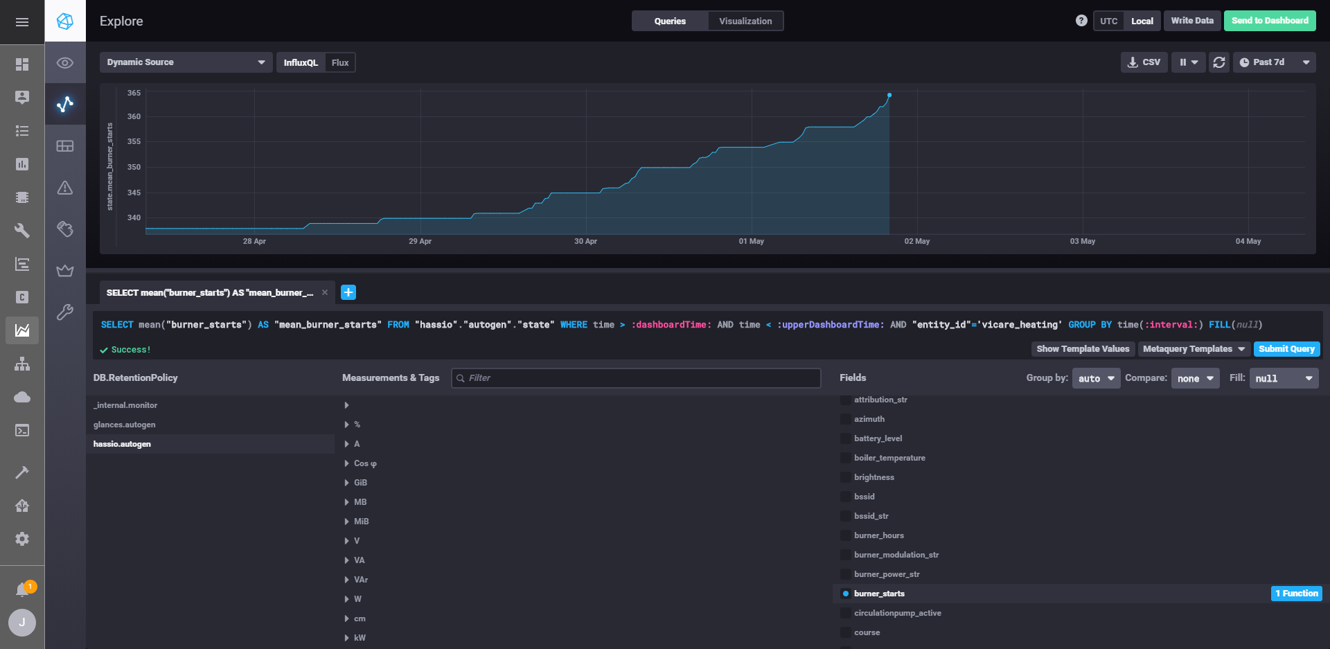

I just won’t read certain values and it will probably be related to the fact that my type of boiler is oil. Otherwise, since yesterday I lost the opportunity to see the number of burner starts and the number of burner hours. I don’t know what happened and why it disappeared, but I didn’t find a fault with me. I even tried to upload a 2 day old backup, but this data can no longer be obtained. As if it were not sent by the API.

My bad i was so excited i got it to work.
It has everything to do with he viesmann app.
When you add the heating to the app on the phone you can name the circut for it. in my case i named it grijanje = serbian for heating.
This got transfered to the Viessman component. It could be easily happening that the entity is not called vicare_heating which is the default name but somthing else.
I found the name in the developer tools -> states and searched for outside_temperature then there it was named oddly climate.grijanje_heating
It changed names to… so just find it under states and use it for the templates.
So you just need to replace the
friendly_name: “Active circulation pump”
value_template: “{{state_attr (‘climate.vicare_heating’, ‘circpump_active’)}}” "
with the correct climate.xxxxx value and it would work.

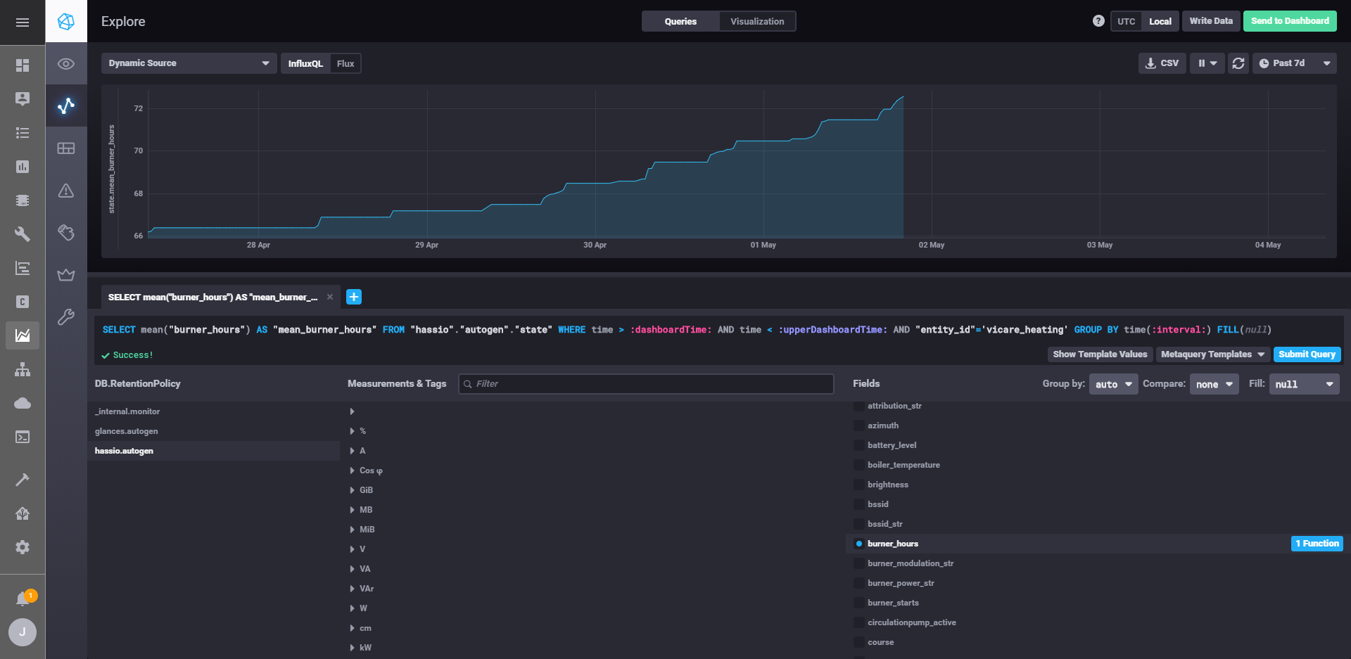

I am enclosing a screen from InfluxDB where 3 days ago I saw through the settings of the gas boiler the number of burner starts and the number of burner hours.
And please do you have all the data from the API and what kind of boiler do you have?
Yes, thats completely different. This integration uses data from https://api.viessmann-platform.io/. Thats the same data which is available in the Viessmann ViCare App on iOS and Android as soon as you connect your Vitoconnect 100 to the internet. Hence the name “vicare”.

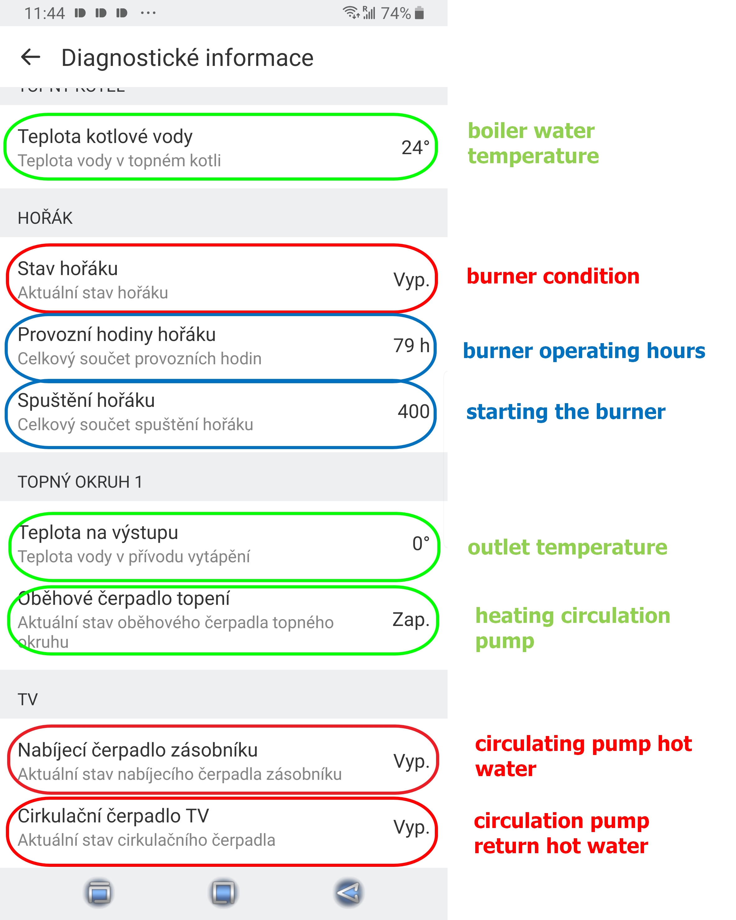

OK. Thanks for the reply. Even if you write that it is a different API, it still does not correspond to the attributes I have in HA.
In the picture from the Android API, the attributes I have in HA are marked in GREEN. RED which I don’t have and never have and BLUE which I still had 3 days ago.
So any explanation? If the gas and oil settings are the same, it should be there as well. I’m pretty desperate for that.
