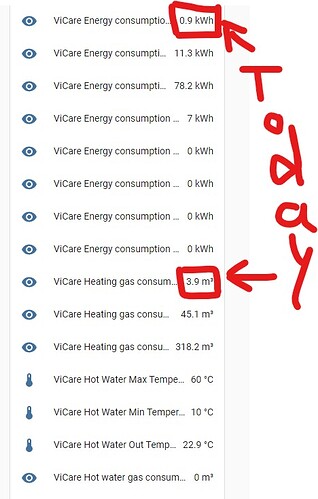

Hello, just added viessman gas heater, and those sensors cant be added in energy configuration (neither gas or eletricity) units seems to be good. Anyone know how to fix it?

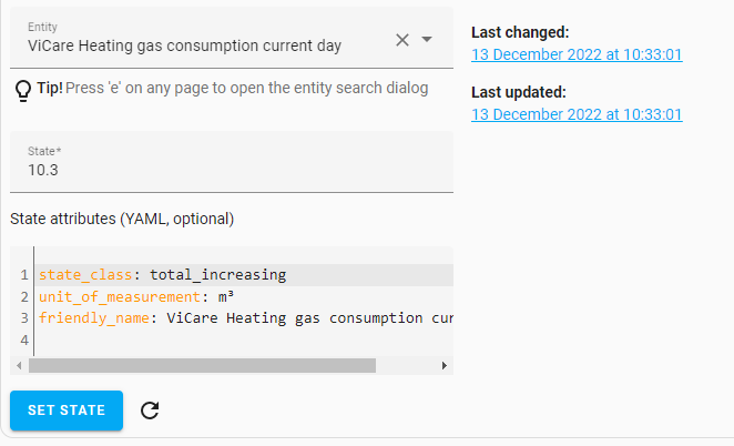

oischinger, i have only those states, can you or someone confirm that this should be enough to work? (Just waiting for update then)
Don’t need to also have
device_class: energy ?
looks pretty similar… works just fine.
Maybe you added it before bug appear? Can you please check in energy configuration gas dropdown menu if still can choose it there?
I have only electricity sensors there…
Sensors which are allowed to add have
You’re right that i initially added it many months ago, but it still shows up as available to add (as do the other ViCare gas consumption sensors).
Thanks for checking. Interesting why not working for me, as everything looks same.
Dont want to spam here. Any advice how should i proceed?
This seems to fix it for me, but still need some time to watch if everything is ok :slight_smile:
