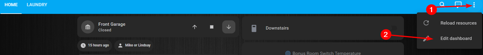

  • Edit dashboard.

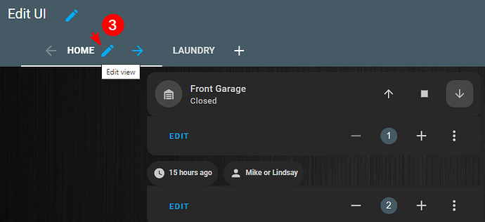

  • Select the view icon.
  • Click the pencil icon that appears.
  • Choose the Visibility tab.
