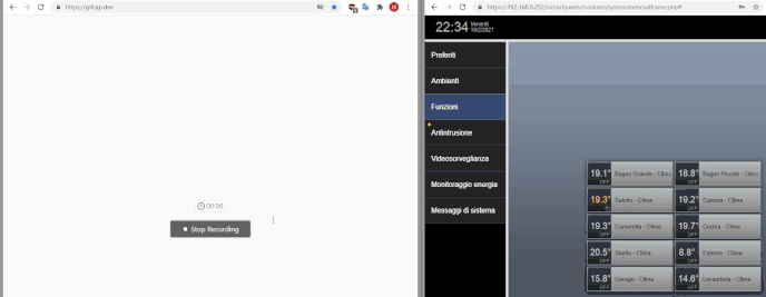

Hi Andi
After the last update the thermostats no longer work.
For example…
When I turn off the heating, the off command is sent but the heating continues to work. Before the update it worked fine.
The reverse operation also fails
I attach a video

@pod: i changed some things in the last days - and just uploaded a new version. can you try it again?
Tested.
Auto mode now works fine.
But the manual mode still has problems
The command is sent but the thermostat does not start.
