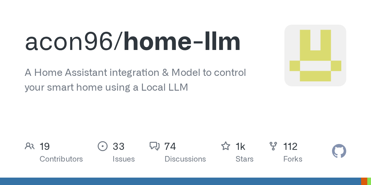

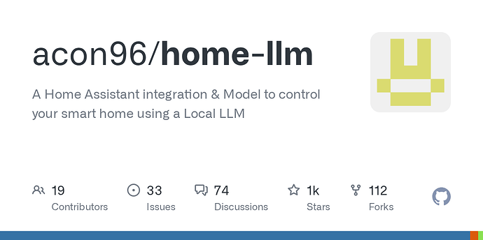

What integration are you using in home assistant for the llm? I try updating it or using
