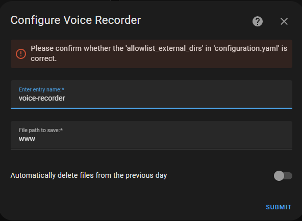

if i try to change my path to local i get this
Screenshot 2025-01-15 160439
Sorry, I didn’t explain it clearly.
You don’t need to change the configuration, just change the media_content_id URL. When using the URL, “www” must be replaced with “local”.

In the config I’ve used www. These is no audiofile appearing in this folder if I try to record with pc browser of through the iPhone app. If I change it to local, I get the ‘Please confirm whether the ‘allowlist_external_dirs’ in ‘configuration.yaml’ is correct.’
I’m stuck there, because I don’t know what to change in my configuration.yaml.
I’ve installed browsermod, but haven’t done anything with it yet. Do I need to do anything with this too?
You only need to enter www or www/your_dir, and that will work.
