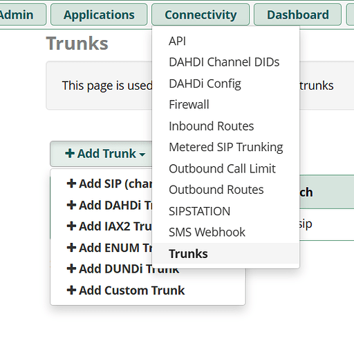

Add the HA’s server as a trunk
Go to Connectivity -> Trunks, add a new SIP (chan_pjisp) trunk.
In the General tab, set a trunk name.
