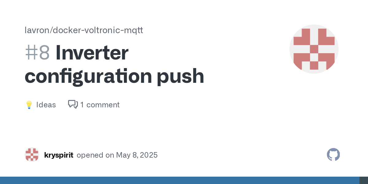

Thanks for all your effort, after following your instructions I got the values to display in HA. Just one question of modifying inverter mode, is it possible to post a MQTT command to change the inverter mode? I am not to much familiar with MQTT at this moment. Also if it is possible to change the battery charging current via home assistant.
We got a solution here:
I’m planning on adding this functionality to the next release.
