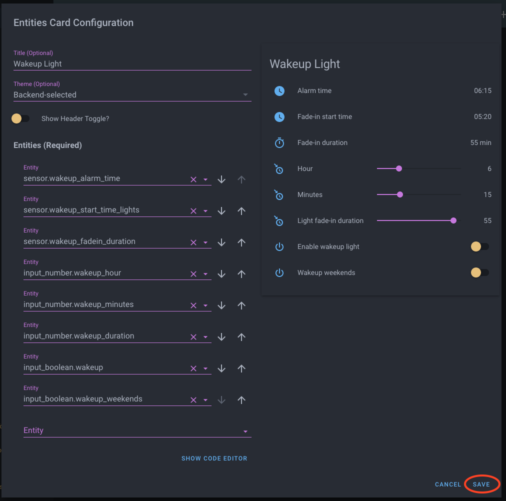

Here’s a detailed n00b guide for setting up the lovelace card:)
Step 1:
In the upper right corner there you should have this three dotted button. Press it.
(I’ve made a new view named “WAKEUP” for this guide).
wake1
Step 2:
Select “Configure UI”.
wake2
Step 3:
Add a new card by pressing the “+” icon.
wake3
Step 4:
Select “ENTITIES”.
Step 5:
Build the card as shown here. You may have different entity names. Press save when finished.
You are my personal hero!
Thanks! Also this is so starting to make sense now. The input booleans I put into the config is put into the backend of the lovelace card.
And the journey continues! Next up ADB to my Android nVidia Shield for light automation with media play
No problem:)
Yes, the lovelace card / frontend is just a visual representation of entities. There is no logic in the card itself. In ny original post I used a group to display the input parameters, but now we can use the lovelace card.
