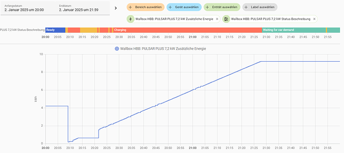

Here is a status overlay and in this case it looks like charging or new connection has started the reset. You can always see the red charging state and the green which means waiting for car demand.
and here a zoom
and another one which is not really clearer.
ORANGE = disconnected
Here is another example where it shows “disconnected” during charging for a short moment so I am not sure if that is helpfull.

Now it has become even far more tricky cause as you can see in the 2nd charge there was a short red charging session, followed by a short disconnect at 20:10 and followed by the next charging session while the energy counter has not been resetted.
A new connection and a new charge should have reseted the counter, but the line went straight horizontally to increase again after 2 minutes or so.
