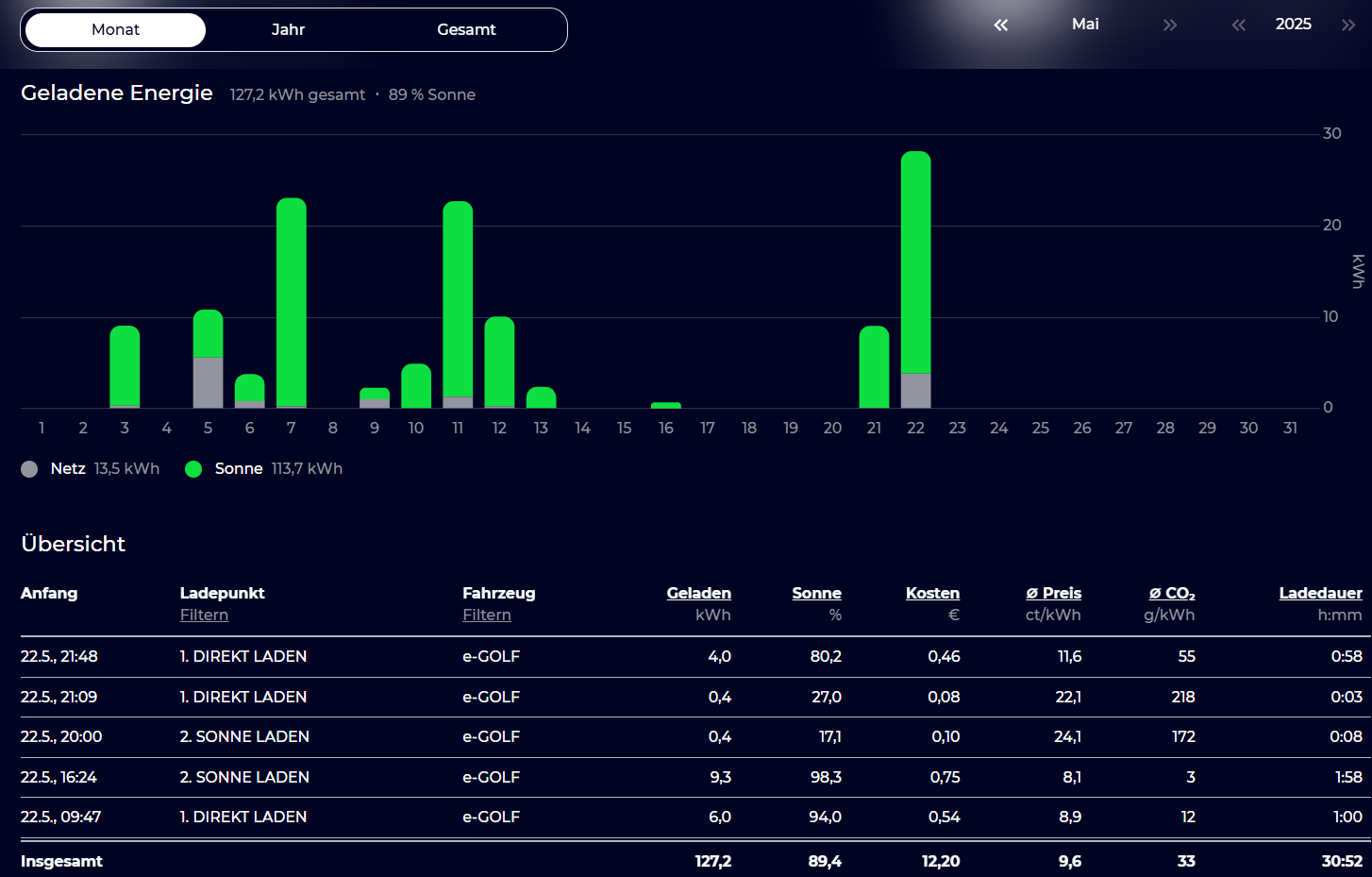

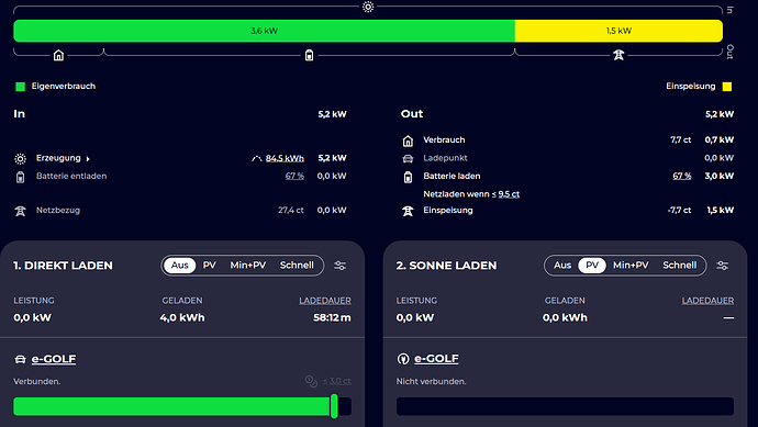

I suggest to get evcc from github cause that is a solution that is designed to work brand independently.
We have a
  • family of growatt inverters
  • diy battery with JK BMS
  • eastron smartmeter SDM630
  • pulsar plus 11 kW
And it is working once you have figured out your configuration.
Here are our 2 Pulsar Plus just plugged in
And here are our stats
