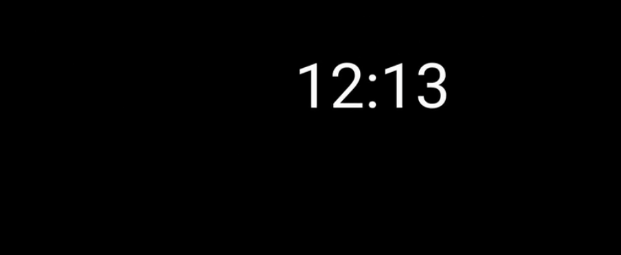

I would like to change font size in custom-clock card in wallpanel.
No matter what I do, I can’t figure out how to enlarge text…

Everything else is working without any problem… Thank you for all suggestions.
BTW: tried with cardmod, styles for wall panel, …
