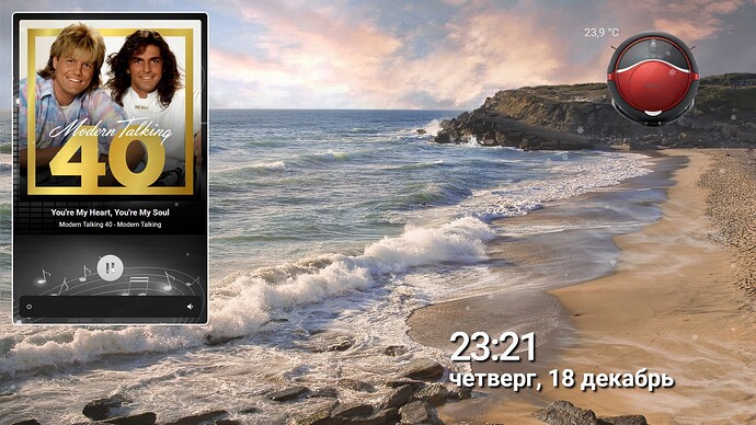

Hello. This is the Wall Panel I made. The cards pop up when music plays or the vacuum cleaner cleans. Maybe someone else might find it useful.
wallpanel:
  enabled: true
  hide_sidebar: false
  hide_toolbar: false
  fullscreen: true
  idle_time: 5
  image_url: media-source://media_source/local/ocean
  cards:
    - type: picture-elements
      wp_style:
        width: 400px
        grid-row: 1
        grid-column: 4
      elements:
        - type: image
          entity: select.vacuum_lamp
          state_image:
            'on': /local/imades/vacuumanim.gif
            'off': /local/imades/vacuum.png
          style:
            left: 50%
            top: 50%
            width: 70%
        - type: state-label
          entity: sensor.datchik_t_h_temperature
          style:
            left: 9%
            top: 10%
            transform: scale(2,2)
      image: /local/images/vacuum_lamp.png
      entity: cover.blinds_curtain
      card_mod:
        style: >
          ha-card {
          background-color: rgba(0, 0, 0, 0); border: solid rgba(0, 0,0,0);
          display: {% if is_state('select.vacuum_lamp', 'idle') or
          is_state('select.vacuum_lamp', 'off') %} none {% else %} block {%
          endif%};
    - type: custom:mediocre-massive-media-player-card
      entity_id: media_player.kolonka
      mode: card
      action: {}
      options:
        always_show_power_button: true
        use_volume_up_down_for_step_buttons: true
      card_mod:
        style: |
          ha-card {
            display: {% if is_state('media_player.kolonka_2', 'idle') or
            is_state('media_player.kolonka_2', 'off') %} none {% else %} block {% endif
            background: url('/local/radio/music.jpg');
            background-color: #30254f; border: solid 2px white; box-shadow: none;
            border: solid 3px white; box-shadow: none;
            align-items: center;
            j ustify-content: center;
            height: 100%;
            overflow: hidden;
            --accent-color: pink;
            --primary-color: white;
            --secondary-text-color: white;
            --secondary-background-color: pink;
    - type: custom:digital-clock
      timeFormat: HH:mm
      dateFormat: cccc, d LLLL
      card_mod:
        style: |
          ha-card {
            is_state('media_player.kolonka_2', 'off') %} none {% else %} block {% endif%};
            position: absolute;
            z-index: 1;
            text-align: left !important;
            background-color: transparent !important;
            border: none !important;
            padding-left: 1200px !important;
            padding-top: 20px !important;
          .first-line {
            font-size: 100px !important;
            letter-spacing: -5px;
            font-weight: 500;
            font-family: "Roboto", sans-serif;
            color: #FFFFFF;
            text-shadow: 5px 5px 5px #000000;
          .second-line {
            font-size: 60px !important;
            font-weight: 600;
            color: #FFFFFF;
      wp_style:
        width: 400px
        grid-row: 1
        grid-column: 2
      timeFormat: HH:mm
      card_mod:
        style: |
          ha-card {
            position: absolute;
            z-index: 1;
            padding-left: 600px !important;
            padding-top: 800px !important;
          .first-line {
            font-weight: 500;
            color: #FFFFFF;
          .second-line {
            font-weight: 600;
            color: #FFFFFF;
      view_layout:
        grid-area: photo
