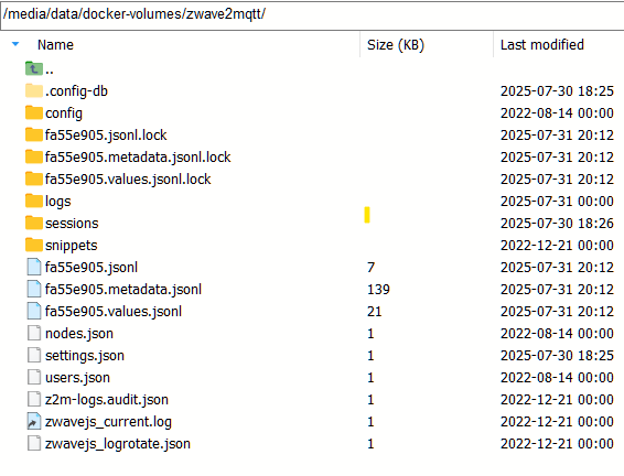

I don’t know how your HA add-on is storing the device information, but on my volume mapping …zwave2mqtt i have several directories and files that i would try to migrate.
You might try to find these files on your installation.
