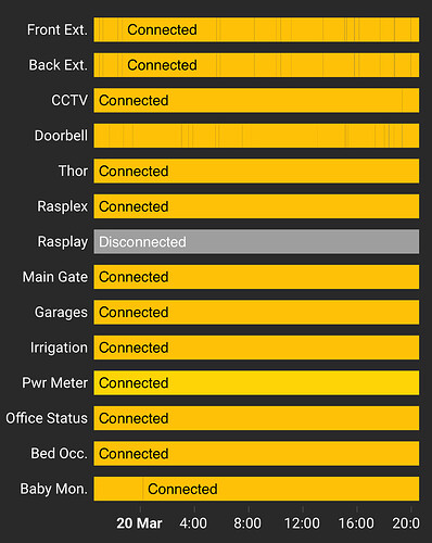

Thanks, yes ideally I’d like a page with a view of all the devices connected to HA and their historic availability. That way I can see if certain devices are having connectivity issues, if there are general networking problems etc. I think you’re right about binary sensors, I’ll take a look into that.
One can e.g. for ESPHome devices configure a connection sensor, which is useful for that purpose.
I have a card to monitor devices like you talk about. I use all of the options mentioned.

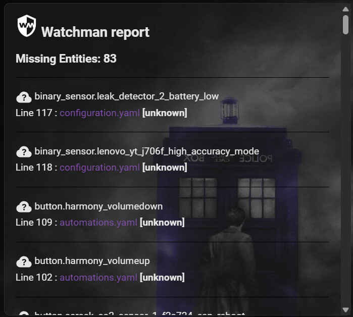

An adjusted Mark Down Card with scroll.
type: markdown
entity_id: sensor.watchman_missing_entities
card_size: 6
card_mod:
  style: |
    ha-card.type-markdown {
      max-height: 450px;
      overflow-y: auto;
      padding: 0px;
content: >-
  <h2 style="margin:2px 0;"><img src="https://brands.home-assistant.io/watchman/dark_logo.png" alt="WM Logo" width="32" height="32"> Watchman report</h2>
  <h3 style="margin:2px 0 6px 0;">Missing Entities: {{ states('sensor.watchman_missing_entities') }}</h3>
  {% set items = state_attr('sensor.watchman_missing_entities','entities') | default([], true) %}
  {% for item in items | sort(attribute='id') -%}
  <hr style="margin:6px 0;border:none;border-top:1px solid var(--divider-color,rgba(255,255,255,.2));opacity:.35;">
  {% set raw_occs = item.occurrences | default([], true) %}
  {% set occs = raw_occs if (raw_occs is iterable and not (raw_occs is string)) else [raw_occs] %}
  {% set occ0 = (occs[0] | string) %}
  {% set f0 = occ0.rsplit('/',1)[-1] %}
  {% set fname0 = f0.rsplit(':',1)[0] %}
  {% set line0 = f0.rsplit(':',1) | last %}
  {% set state_txt = item.state | default('unknown') %}
  <span style="display:flex;align-items:center;gap:6px;line-height:1.1;margin:2px 0;">
    <ha-icon style="--mdc-icon-size:18px;vertical-align:middle;"
             icon="{{ 'mdi:cloud-alert' if item.state == 'missing'
                      else 'mdi:cloud-off-outline' if item.state == 'unavail'
                      else 'mdi:cloud-question' }}"></ha-icon>
    <span>{{ item.id }}</span>
  </span>
  <div style="display:flex;align-items:baseline;gap:8px;white-space:nowrap;width:100%;box-sizing:border-box;line-height:1.1;margin:2px 0;">
    <span style="font-family:monospace;flex:0 0 auto;">{% if line0|int(0) > 0 %}Line {{ line0 }} : {% endif %}</span>
    <span style="font-family:monospace;flex:1 1 auto;min-width:0;overflow:hidden;text-overflow:ellipsis;">
      <a title="{{ occ0 }}" style="font-family:inherit;color:inherit;text-decoration:underline;text-underline-offset:2px;">{{ fname0 }} </a>
    </span>
    <strong style="flex:0 0 auto;color:#fff;">[{{ state_txt }}]</strong>
  </div>
  {% for o in occs[1:] -%}
  {% set s = (o|string) %}
  {% set f = s.rsplit('/',1)[-1] %}
  {% set fn = f.rsplit(':',1)[0] %}
  {% set ln = f.rsplit(':',1) | last %}
    <span style="font-family:monospace;flex:0 0 auto;">{% if ln|int(0) > 0 %}Line {{ ln }} : {% endif %}</span>
      <a title="{{ s }}" style="font-family:inherit;color:inherit;text-decoration:underline;text-underline-offset:2px;">{{ fn }} </a>
    </span>
    <span style="flex:0 0 auto;visibility:hidden;">[{{ state_txt }}]</span>
  </div>
  {%- endfor %}
  {%- endfor %}

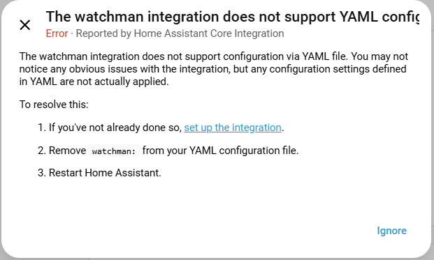

I don’t know if it’s related, but my upgrade to Watchman 0.8.1 results in an error I’ve never seen:
It doesn’t say which yaml file it doesn’t like.
Other than this error message, I am not seeing any memory issues or other anomalies.
