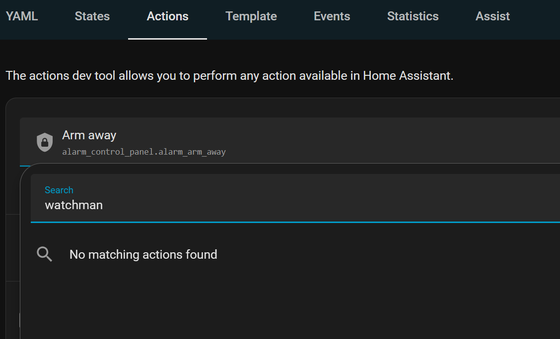

Hi, I’m not sure if I am doing something wrong here but I can’t seem to trigger a report under the devtools, actions. When I try to search for watchman no results are shown, and even trying a manual entry of the watchman: report action doesn’t work. It’s installed via HACS, and I even tried to redownload it but it still doesn’t show up. Maybe it’s not compatible with the latest HA? I am using 2026.1.3 at the moment.
OK, been reading this thread. I’ve removed the files and then downloaded the DEV version and created the integration, now it’s got a simple ā€œpressā€ link to create a report, testing this now.
Thank you for the utility!
Dennis
You should search for the ā€œReportā€ action.
