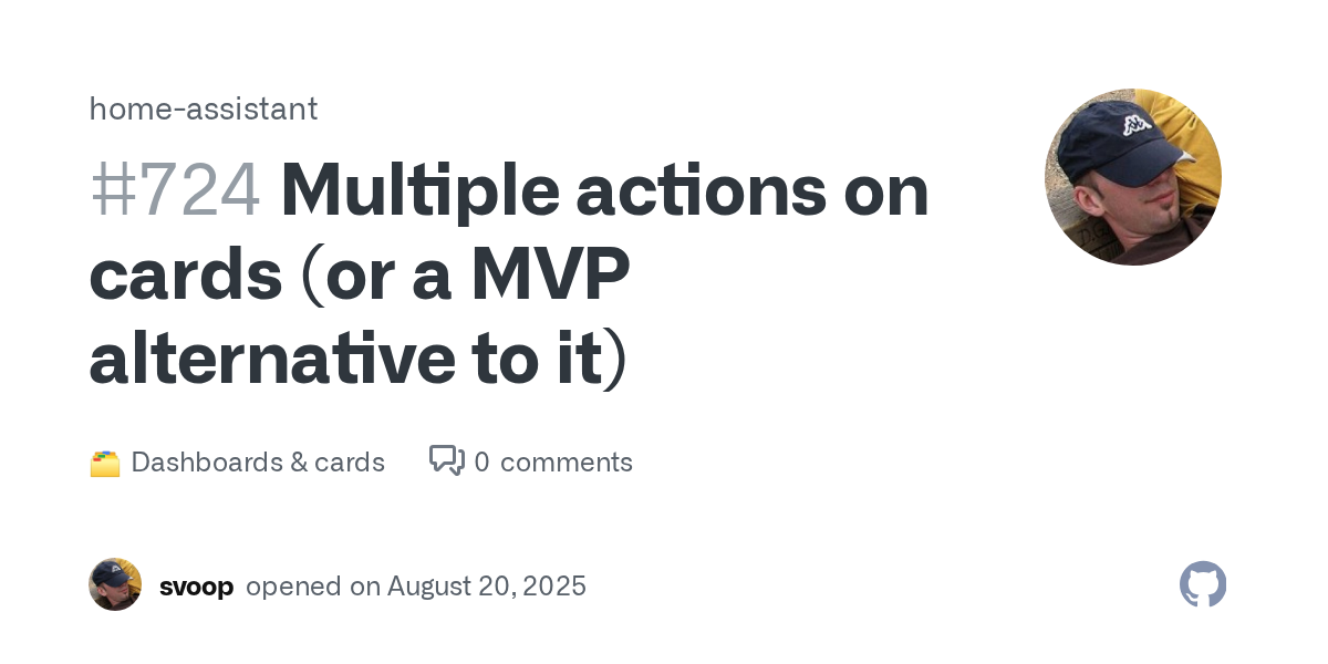

Many users are asking for this particular feature, you might want to upvote the corresponding feature request:
