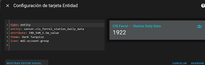

Hi, first things first, good job, and thank you.
I am trying to replicate this cards because its lovely. but i encountered problems in the first steps.
the weather station in my town is a sensor with many atributes, for example,
type: entity
entity: sensor.cis_ferrol_station_daily_data
attribute: IRD_SUM_1.5m_value
this outputs the following
this is one of the values available, the point is if I add the attribute line to your code, it doesn´t work
I have tried this
type: entity

with no resuts, well there´s an output, the card says available
so, how can I add these data to my dash?
I cant help you with your solar lux pull as I dont have your sensor and details of how each attriubute is listed. sorry
I would love a tides, screen but my issue is only polling once a day causes tide service to block me saying out of credits.
Hi, I am talking about a public service provided in my country, you can take a look here meteogalicia.gal
In fact It is a n integration existent into HACKS.
Anyways if you can help ,e, i can provider any info you would like.
Thank you.
