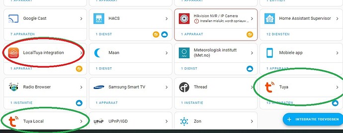

I got confused, see picture. I was constantly trying to add the heat pump via localtuya intergration (the red circle).
That is possible.
So that didn’t go well.
I thought every time that Tuya Local (bottom green circle) was only for the login of the complete Iot platform.
My english is not always very good.
When I looked closer I saw in one that you could immediately add a device there.
And that went well in 1 times!
Stupid of me :D.
But it works now!!! As you say pergola.fabio.
Very happy!
Thank you pergola.fabio!!!
Perfeft, seems you have 3 different versions of tuya integrations, try to use only 1 and ditch the other 2 :slight_smile:
