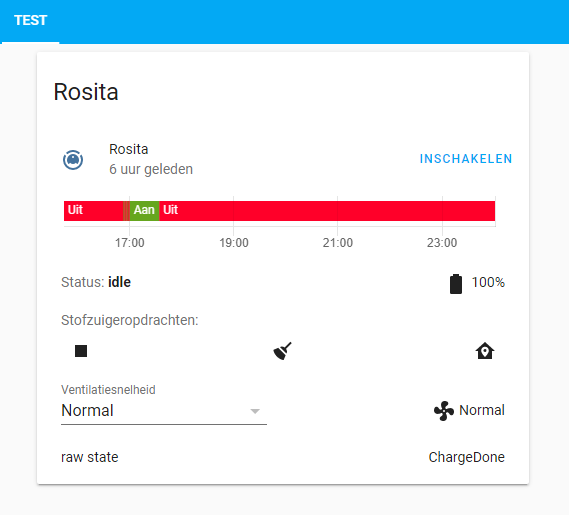

Great solutions. Tested it on my x500 works fine. Now I need to create a nice Lovelace card with all the options and data.
I was looking for the same thing. Just installed: https://github.com/thomasloven/lovelace-more-info-card
@Remco_Timmer @kwaczek @splnut
Could you please capture as many raw states as you can for me? You can check them in the bottom of the vacuum card. I need them to create aliases between Home Assistant states and WeBack ones. For example, turn robot in auto mode and write down raw state. Then put it back on charge, wait for it to finish etc.
Thank you
