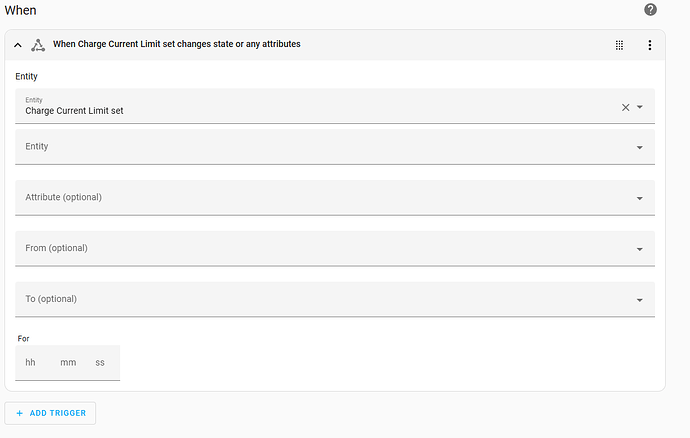

You must have an Entity that measures the current/power generated by the solar panel. You can then create (using the visual editor) an Automation that triggers on state changes of this entity.
This will look a little like the following Automation I use when updating the slider:
Under ‘When’ is the trigger, which expands like this:
In the ‘Then do’ section you will set the current limit in de the wallbox using the modbus register. Like this:
Hello BrainDra1n, thank you very much! it works now

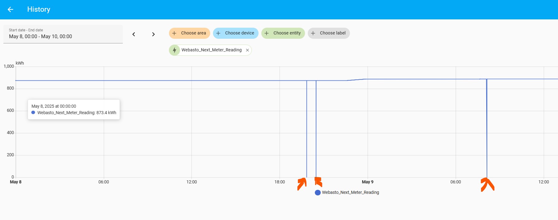

Any body else experiencing issues with Meter Reading that either daily or several times a day suddenly measures zero in total kWh? When it return to normal again, Home Assistant think I have used for example 873 kWh in a single day. See the attached image.
I do see the same behaviour.
My Webasto Next has a certified MID meter for energy. Looks like the 0 value is ‘read’ only once and is correct in the next messurement.
I use this value to calculate the actual cost of charging (using the Utility Meter). This seems to work despite this behaviour.

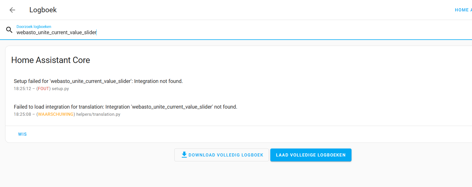

Thank You all guys, with the help of You and webasto next integration, copilot made me an integration for Unite model - GitHub - matkvaid/webasto_unite_modbus
i want to use evse load balancer and it did not work with a list of entites, was asking for a device
