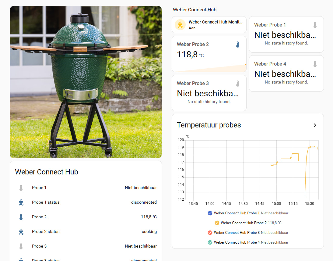

I made this small dashboard:
I'm not very much into UX. Suggestions are welcome!
