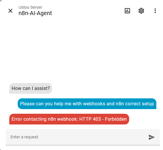

Thank you for this integration. I only just started using n8n integration and installed on to my HA but im struggling to find any clear instruction on how to set up the Webhooks url in n8n. I cant get to the n8n instance if I use my “https://MyDomain:5678” but I can access my HA on “https://MyDomain” I have Nuba Casa subscription but in my attempts to get n8n working I also got a domain name from CloudFlare account.
My n8n AI Agent that i made is working fine, but your n8n Conversation returns the below error on the Webhooks:
There seems to be very little information out there for n8n installation on HA, I would be very grateful if you could guide me on that aspect so that I can use your n8n Conversation.
This doesn’t seem to be caused by the integration itself. You will need to ensure your n8n webhook URL is reachable from the machine running Home Assistant. To debug you could try curling the URL from a terminal on your HA machine (you could ask AI how to do that).
403 Error also indicates that you might have some kind of authentication issue, perhaps you have some authentication mechanism for your n8n URL. The webhook needs to be accessible without having to authenticate.
@EuleMitKeule Thank you for the reply. Is the n8n Webhook simple the local IP address in which n8n can be reached within my local network?
No, you have to create a webhook entry node and copy the production webhook URL from the node. You also have to set the workflow active in n8n for it to listen to requests.

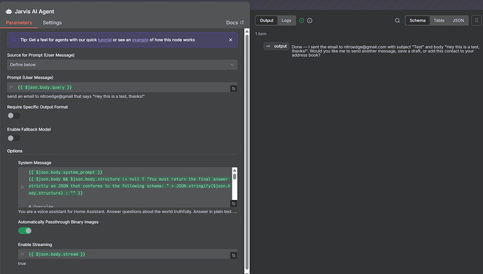

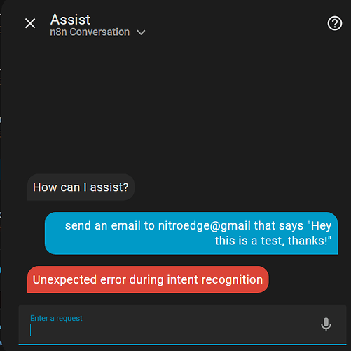

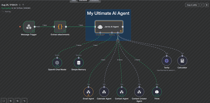

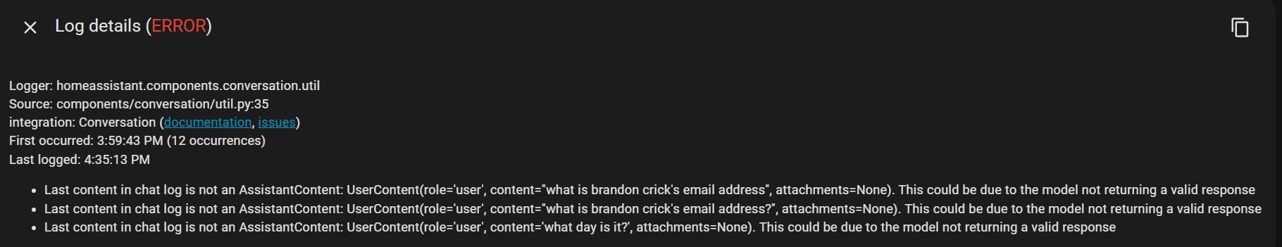

I modified the workflow a bit to add in some tool agents and was wondering if you encountered this before. Basic questions and inquiries to search the web are working for me.
I’m receiving a error “Unexpected error during intent recognition” even though the output is generated as my screenshots show.
Have you experienced this before?

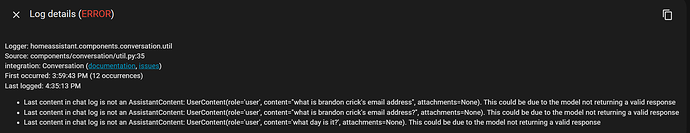

Here’s my error log from HA:
In your last screenshot I can see the workflow ran for over one minute. Did you increase the timeout in the webhook conversation integration config options? Per default it times out after 30 seconds.
I’ll increase the limit, great catch, I did notice some runs take much longer.
I noticed n8n released a new AI Agent Tool node that we can now connect to the master AI Agent tool output and we don’t need to use the “$fromAI” variable and setup any longer, we can simply click the option on the far right of the option box to “Let the AI Agent decide what is best” which is really cool.
Still learning the overall flow and trying to understand why in your workflow you don’t need a Respond Hook to the right of your master Agent and other workflows I’ve seen have this node.
