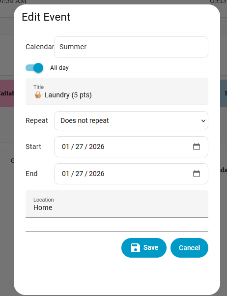

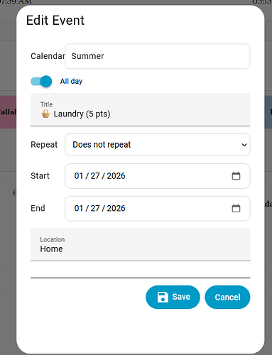

I’m using the local calendars. I tried clicking a blank day and did not get an option to add, but I just click the “add event” button to add the events, and when I click existing events I get the options now to edit and delete. The edit and delete work great - Having those options for the existing events is a massive improvement. Is there an extra option I need to add to the config for getting the add event to popup on clicking blank days? Definitely willing to test.

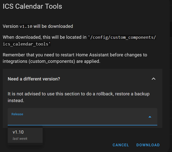

It doesn’t look like that this has pushed to HACS yet.
showing for me but may take longer for some people to see it? I know hacs saves resources by checking less frequently. You should be able to force a refresh by selecting “Need different version?”
you need to look at week planner card plus for update not ics calendar tools
Doh!, I completely misread your initial post. Thanks.

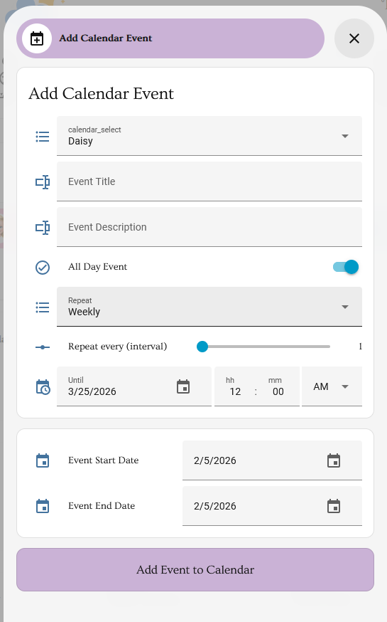

I have working recurring events now i can upload to github but requires updating both integrations. but it works perfectly. if you guys will test ill up it
2.0.0 released for both packages with full support for repeating/recurring events.
