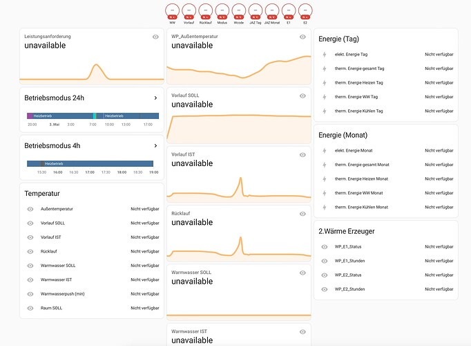

Has anyone installed the new version 2024.5.0 and checked whether it solves the problem?
I have tested version 2024.5.0. Unfortunately, as with the other versions, all data is displayed for approx. 5-10 seconds after the start, then it disappears.
currently i updated my Microsoft Hyper-V testsystem to 2024.5.1 modbus is still working.
Here´s the solution ![]()
copy your yaml to my MS Hyper-V 2024.5.1 testsystem, your yaml is not working.
your âclimate:â is not working, remove it and try again - see below. I thinks it´s not allowed to use the same address for current temp and target temp.
I fixed the code - see below. The issue was that slave: 1 was missing at the climate
after a change you need to restart HA, only reload modbus is not working.
your welcome ![]()

Unfortunately, it doesnât work with the 2024.5.1 update either. The information is displayed for approx. 10 seconds, after which unavailable appears.
