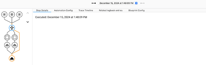

- While I am using blueprint it gives me error for line 43 (minutes: “/{{ (timer_interval | int) }}” If I do this '1’for test for example I can create automation.
Error: Message malformed: invalid time_pattern value for dictionary value @ data[‘minutes’] - When I trigger automation, it does not set any value. When I was seeing log of zigbee2MQTT I saw that, device name is gotten unknown by automation. And also in the trace I can see that it could not get device name of TRV(last screenshot can be seen) After that I played with code again now it doesn’t give Z2M log but when I see trace, now temperature is unknown I am sure that TRV and thermistor working.
Trace:
