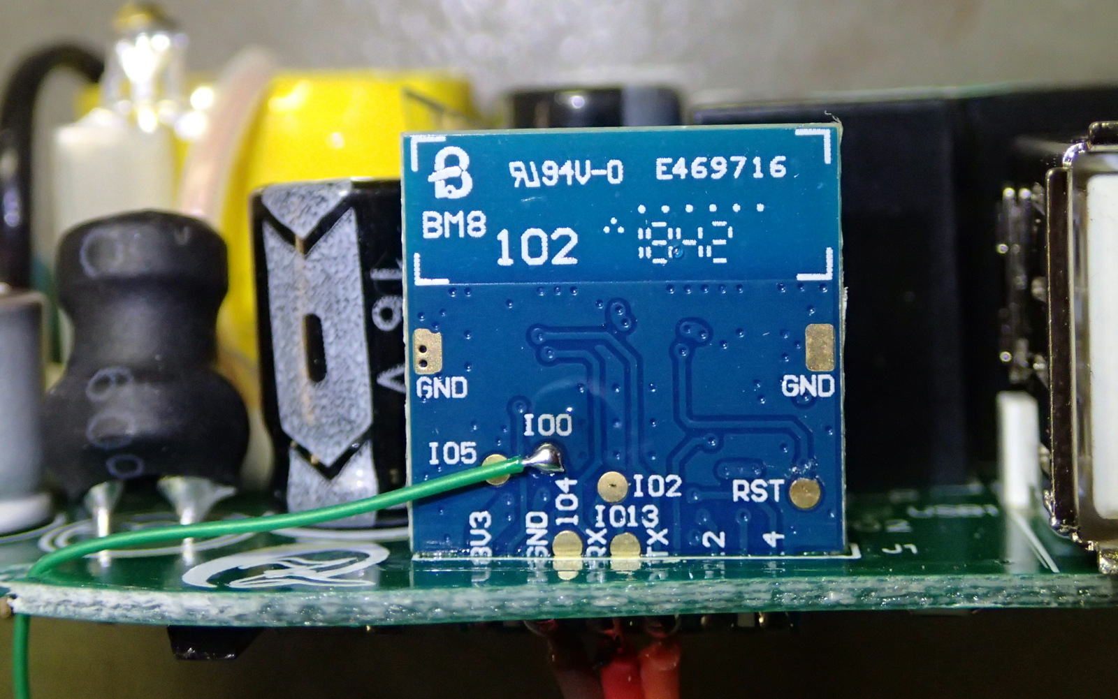

I’ve flashed two of the Brilliant Smart Plugs from Bunnings with ESPhome as well now. I took a good photo of the WiFi PCB while at it, because there are spare pads there that might be OK for sensors (like DS18B20 etc). I personally used the hardwire serial method, as I could do that much faster than setting up the tool chain for the OTA method. The USB port is connected to the ESP modules 3.3V regulator input, so the unit can be power up from a USB power bank or PC for flashing.
I’ve done the same to one of these, and the Aldi Medion ones that were on sale a few weeks ago.
I found that the OTA method didn’t work, so I suspect they include the security patch from Tuya to prevent it.
Are the other GPIOs ok to use if connected to mains voltage?
