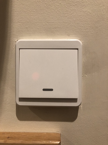

Rather more on-topic - I decided a few weeks ago to gamble a tenner on being able to flash Tasmota on to one of these -
Has anyone else already tried that?
Just in case anyone cares - the switch turned up, and flashed via sonota quite easily. It has quite a cheap feel, and the thing that looks like an led at the bottom isn’t. (Though there is a red led behind the white part of the switch.)
Seems to be a bit of a bargain - I’ll be ordering a few more if it stands up to use over the next week or two.

But to give you some verbal picture:
- looking at it from the front, the outside ring section easily prises off leaving the body of the switch exposed
- that body has standard fitting screw holes left and right to attach to the wall box
- the largest part of the switch is hinged at the top, and is raised to upright to access the screw holes
- three (yes, three) microswitches are visible on a daughter board when the switch is lifted at the hinge. The middle one is clicked by the hinged switch when it is closed. I did not try the other two while it was live, though suspect that they are there so the same board can be used also for the 2- and 3-switch models. The red LED is also visible.
- there was no immediately obvious way to take the switch apart to see the main board - though to be fair I didn’t really look. (Mainly because the quality was cheap and I didn’t think it would survive man-handling. It was going to be my next step if sonata had failed.)
- it is marked CE
Actually, as soon as I posted the above I realised I could easily prise the front cover off and lift the hinge without any bother. See below.
