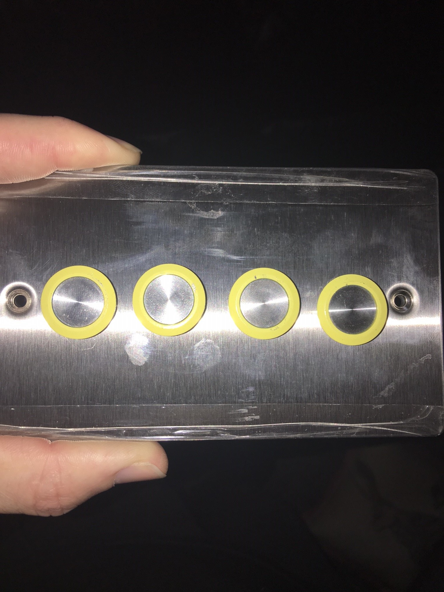

Ive made my own, (not the finished in picture but you get the idea) using a blank face plate and push buttons with a esp8266 wifi board on the back. You would need a 5v supply in the ngang back box to power the esp. The buttons are cheap enough, and you can programme the esp/HA to do what you like.
I would like to be able to do long presses for different functions but havent worked that out yet, any ideas people?
Total cost for me was
ESP £6
Stainless Steel Buttons - Free
Staineles Steel double back plate (screwfix) £5.xx
Hope that helps
Time the length of the press and filter actions based on length?

@frank451, I take it that your switch doesn’t actually perform any mains switching? It just sends a signal to HA for processing?
Correct, when I recabled my house some years ago now, I brought all the feeds and switch wires back to a central location so I had options when technology in the HAuto sector took off. I wanted freedom from the norm, so I wouldn’t be restricted to off the shelf (usually expensive!) products. All my lights are controlled by esp switches/HA via industrial relay controls.
