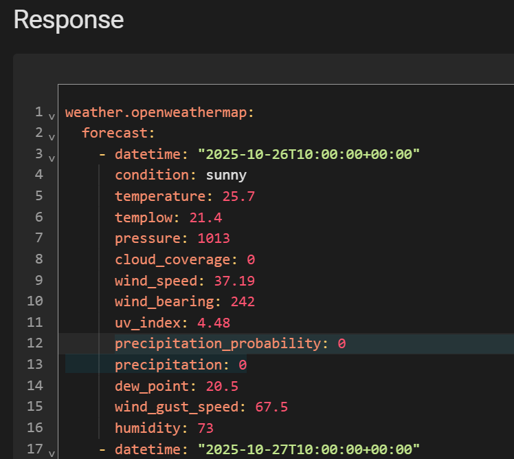

Wait - a bit off topic here, but how / where do you get the precipitation & precipitation_probability…? Could you elaborate a bit on how you get the forecast data and how you use those?
Every weather service in HA which has been updated in the last few years, should provide the get_forecast action I guess.
It’s the current default way to retrieve the weather data from an weather entity.
So you can go to developers tools → actions and run that manually to see the returned data.

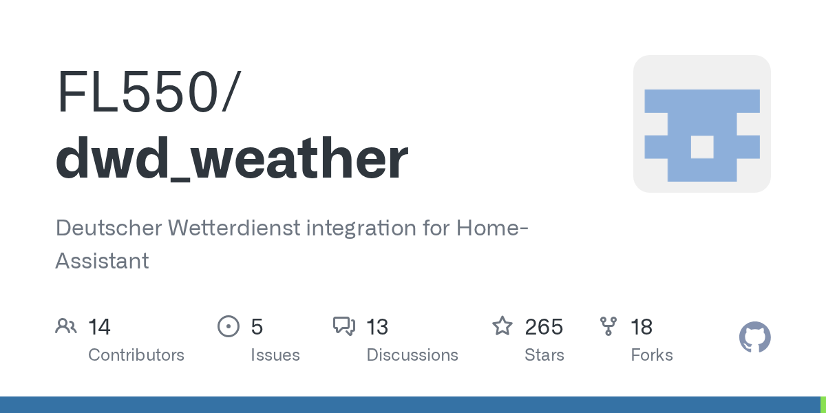

@WagnerJonas as you’re in Germany, you might want to take a look at the DWD custom integration.
I think there is even more than one of them, Inise this one:
It provides both, amount and probability of rain.
And it’s one of the weather models working better for my location.

Developer Tools > Actions > enter weather.get_forecasts, select your weather entity & forecast type > click Perform Action. You’ll get the precipitation properties in the response if your weather provider supports it:
Plenty of threads in these forums explaining how to do that. Here’s the first 3 I found:
Watch out for older threads - the action was previously called get_forecast but now it’s been renamed to get_forecastS. Make sure you use the latter since the old one will no longer work.
If you’re looking at the attributes of the weather entity, you will only find precipitation_unit. Why someone decided this was more important than the amount of precipitation for the day is beyond me.
You have to call the get_forecasts action like I explained in my post above to see the properties you need. OpenMeteo API definitely supports it - if it’s not being returned in the forecast response, you might wanna raise a FR under the integration in Github.
