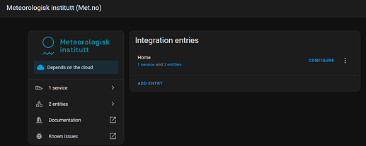

Let me step back. :slight_smile:
As I have the integration here, is the weather service related config still needed?
The only customization what I need, to round the Celsius values on my cards. This was my original config, which became deprecated.
