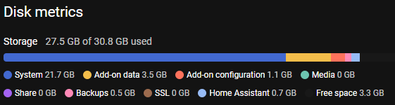

What's using my storage?

I’m not sure this explains why my storage is full:
I can’t run du -shc / | sort -h*, though. Well, I can but it’s been 5 minutes and the Pi didn’t return anything:

I finally have an answer (kind of) :
# du -shc /mnt/data/docker/* | sort -h

I have an old HA install that I have been upgrading for many years.
So if I look at storage I get this:
I’m running HAOS in proxmox. I could easily enlarge the size of the storage for the VM, but would like to know why the “System” keeps growing.
Based on the others in this thread I have tried to look via SSH to see what is taking up space, but it doesn’t make sense to me.
[core-ssh ~]$ df -h
Filesystem                Size      Used Available Use% Mounted on
overlay                  30.8G     27.4G      2.1G  93% /
/dev/sda8                30.8G     27.4G      2.1G  93% /media

I also have the samba share addon installed and using a windows gem called Folder Size I can see that there isn’t 21G of stuff being shared. Frigate is on a network share so the media dir looks larger, but it isn’t on the same disk.
Anybody see anything here that makes sense? I’m kinda at a loss of what to do other than enlarge the disk in the VM, but I am not sure it is needed.
Thanks for any insights one might have.
Run those commands in the “shell” section of the Proxmox VM. You’re likely looking at a docker container, not the HAOS VM. Just enter “login” and press return to get to the command line of the VM once you’ve opened the Proxmox shell.
Did you get anywhere with this? i have the same issue, ever increasing system disk usage on proxmox. I’m at a loss.
I did not get anywhere. Lack of time. Looks very involved to get logged into where you can tell what is really on the (virtual) drive.
