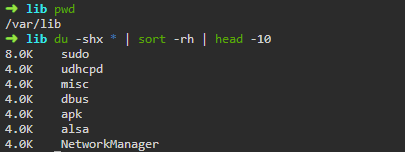

Try some other tool to dive into the detail: e.g. du -shx * | sort -rh | head -10
Needs to run from root with root(sudo)

I am running ubuntu 2020…shx works fine with me but whatever the sort, you can export it to a file and analyse further in eg. excel/spreadsheet… There are more tools besides ‘du’, you can also run them to dig into folder, eg. ncdu… good luck

haos is linux based so I would assume that additional tools should be installable … but sadly I cannot be 100% sure as not known to the haos details…you can just start with ‘du’ and then pipe it to a file that you can readinto excel…‘du’ pumps out a LOT of data though hence the ‘sort’ and ‘head’ in my proposed approach. So…try for instance du --max-depth 2 and dig deeper from there…not that links/mounts can be double counted
