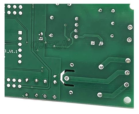

This is an interesting ESP32 board that I have been experimenting with. USD 9 with shipping. Fits into a USA single gang wall box. I am still debating my trust in putting it in the wall, but it seems as well made as many of the devices we think nothing of using in our homes. You can do development with it powered by a TTL Serial to USB converter with it off the mains and then move it to mains when it is to your liking.
AC Powered ESP32 WiFi Single Relay Module ESP32 Development Board
Reading threads like this Songle Relay board safety concerns with 240V make me worry about those relays.
Having said that, I ordered a couple to play with (thanks for the pointer). Don’t know that I’ll be putting them in my wall though.
The creepage distances on the back of that aliexpress board look good. Nice little cutout in the board isolating the relay coil pins from the common relay contact pin.
Though if the relay is flush against the other side of the board it’s kind of useless.
Good points. I’m not interesting in the relay, would rather have a board without it. While you end up with an additional circuit board is pretty much any use of this, having pretty much all the esp32 pins exposed give considerable flexibility.
