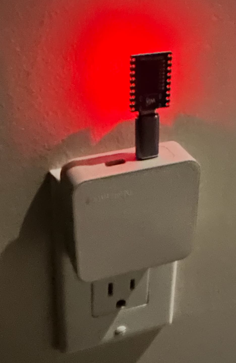

This is how lazy I am. No case at all.
It’s a bit of a waste of an ESP32 for it to be just a BLE proxy, so I use the onboard RGB LED as a motion activated light (motion detector elsewhere).
