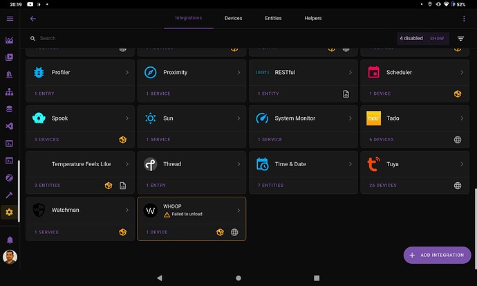

Failed to unload warning? Seemed to occur after adding sensors.
HA Restart resolved.
Logger: homeassistant.config_entries
Source: config_entries.py:963
First occurred: 21:53:34 (1 occurrence)
Last logged: 21:53:34
Error unloading entry Andrew’s WHOOP for whoop
File “/usr/src/homeassistant/homeassistant/config_entries.py”, line 963, in async_unload
result = await component.async_unload_entry(hass, self)
File “/config/custom_components/whoop/init.py”, line 173, in async_unload_entry
unload_ok = await hass.config_entries.async_forward_entry_unload(entry, PLATFORMS)
File “/usr/src/homeassistant/homeassistant/config_entries.py”, line 2665, in async_forward_entry_unload
if domain not in self.hass.config.components:
TypeError: unhashable type: ‘list’
