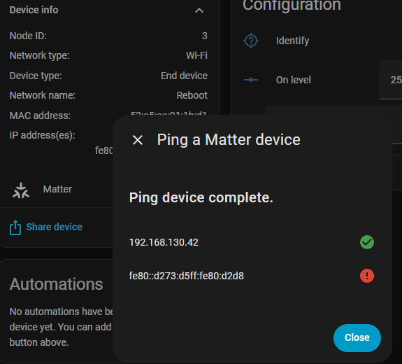

I have a matter device with link local address fe80::d273:d5ff:fe80:d2d8.
I have tried pinging it from my desktop and my NMS and it works fine.
When I try pinging from HA via the Matter setup screen, it fails sometimes, and works sometimes.

I’ve never seen the shell ping, but SOMETIMES the matter screen will ping. It does ping ipv4 always (both matter and shell). The sometimes is rare when it works.

But shouldn’t the matter interface “ping” in HA choose the right interface?

So… it’s a matter integration issue? Maybe something about installing matter with ipv6 off in docker? I’m going to remove it completely and re-add theintegration and re-add the device…
Maybe… if I had to take a wild guess, it would be that the Matter Integration goes and gets these addresses from the Matter Server, and then its the Integration that does the pinging, and as mentioned above, the Integration may not know which interface to ping the link local from so picks the wrong one and gets the failure.
And indeed after removing the matter device, removing the matter integration, adding the integration back, and adding the device back (and earlier enabling IPv6 in docker)…
I can ping it from the HAOS shell, but not from the matter integration ping command.
You’d think the ping command there would have to be smart about HA’s structure. This is all an HA thing right? You mentioned matter server, but that comes in when you add the integration?
So it’s a home assistant bug?

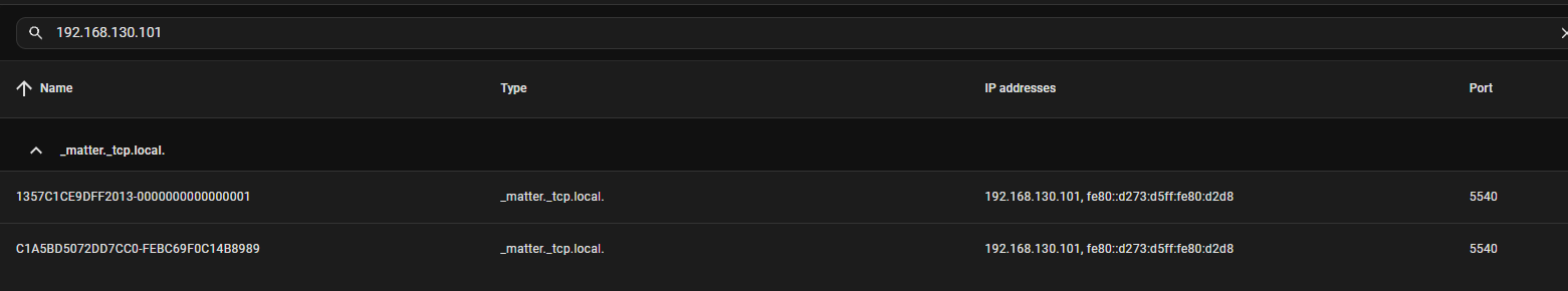

Try HA UI->Settings->Network->Network Discovery Zeroconf Browser and see what it’s _matter._tcp.local shows
Interesting. I didn’t know that existed. Thank you.
It looks better:
Those look like the right address but is also showing the odd duplication, as though each light has two names? Are the names different matter “things” like control vs status or some such?
But it seems to get ipv4 vs ipv6 right here. I wonder why the other browser showed it incorrectly?

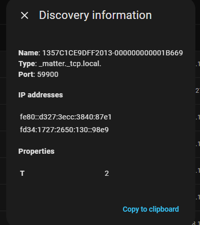

It also shows Home Assistant itself advertising both the link local and DHCP6 assigned ULA. But no ULA for any device, they must not pull DHCP addresses, only link local.
But it would APPEAR that HA knows the right address. I wonder if it’s just a UI glitch that ping doesn’t work? Except it did work once - I saw it. And when it worked it showed a ULA. I’m not smart enough to imagine that - finished in a second or so and one IPv4 and 2 IPv6 addresses, but now it never does that.
